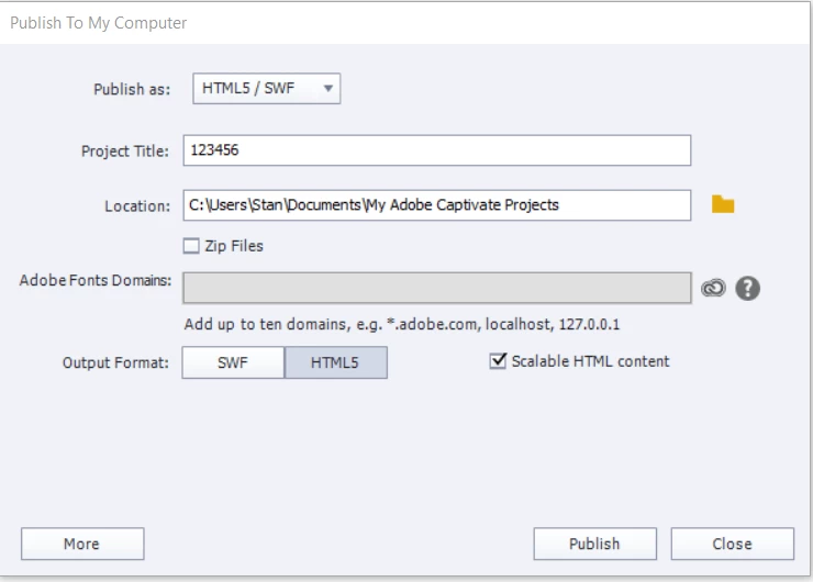

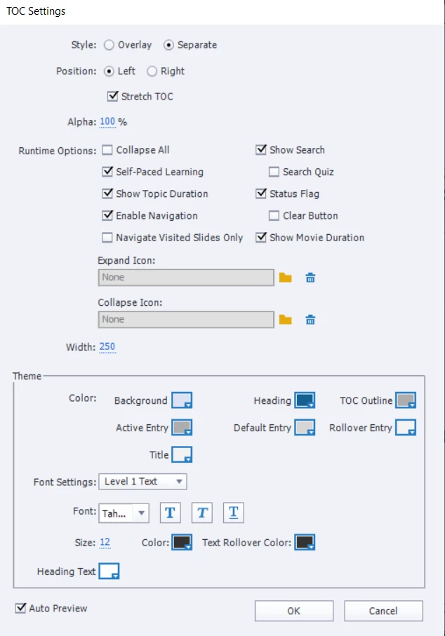

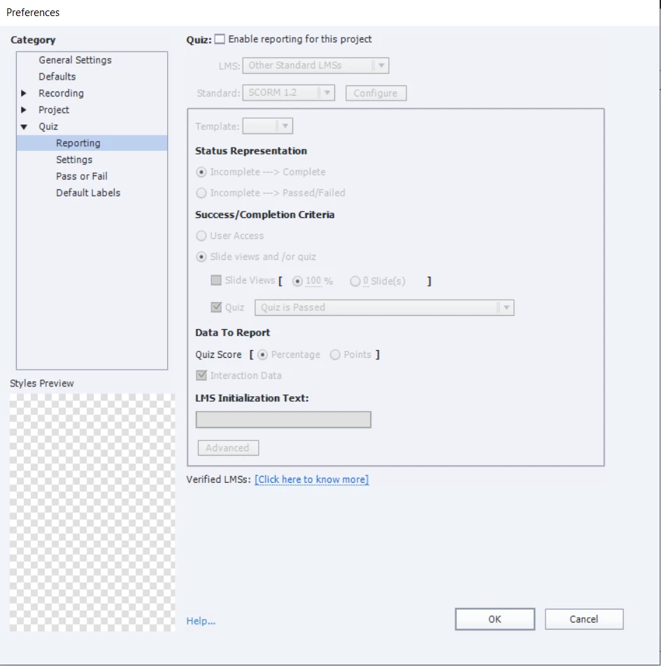

I have the latest version of Captivate 2019 installed, and I want to be able to resume a project from the last visited slide. The project is published to a computer and intended to run from the browser HTML5(see the attached images) and not LMS. Every time I reopen the saved project it takes me to the first slide of the project and not the slide I have last visited. In this case, every time you start the project you will start to form the beginning no matter where you left it. I have the option "Show TOC" enabled and "Self-Place Learning" also enabled. And as I mentioned that the project is not intended for use with LMS I have the option "Enable reporting for this project" disabled.
 According to Captivate documentation enabling the option "Self-Place Learning" will do the trick, but I can't agree. I tried installing and re-installing Captivate, using different versions of Captivate, using different browsers, and installing Captivagte on another computer but nothing works. I have read that some users have the same issue and no solution.

    Bookmarking by TOC is based on local storage. That means that it will only work if the learner re-enters from the same system in same browser and she/he has not cleared the history/cookies. Was that the case?
    Self-paced learning is indeed the option you'll need to activate this type of bookmarking. It works well as I know from the many published outputs on my blog.
