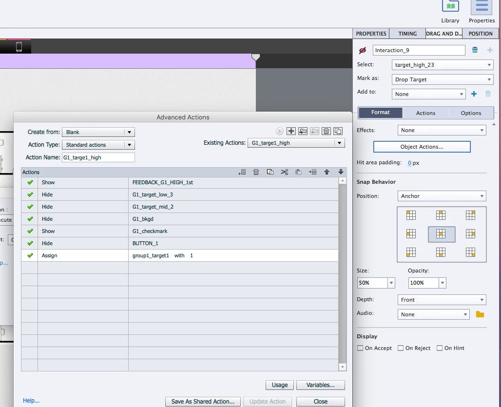

I'd appreciate some ideas on how to make my drag and drop interaction work.
Background:
  1. 8 buttons appear on a screen > each buttons displays a group with 3 drag sources. (Each button's selection is ranked as low, mid, high)
  2. User must choose 3 buttons and select the best option.
  3. Feedback screen shows their selection with a ranking as low, mid, high. Since the there are many outcomes a user can create, I had to create a 3 copies of each feedback and used standard advanced actions to display feedback in an area on the screen depending on which drop target they dragged to.
Issue: On the drag-and-drop page, expanded groups overlap. I can't do "hide X group" because it hides any dragged sources from the target area. I played around with assigning variables as 0 for each target source and once it's dragged assigning it as 1. If it's assigned 1 it displays... I might not be setting it up correctly or it might not work.
TL:DF: Is there any way to set up conditional actions (or any other solution) to hide a group of drop source items but not hide a drop source that has been dragged to a drop target?

Well, the very first thing that comes to mind is that, if I understand correctly, then variables might be the way to go.
If hiding the remainder of the group also hides the selected answer the learner has drug across, you might try making some actions to hide the individual elements.
Something along these lines...?
Hide 'container' (never gets drug and therefore does not need a variable)
If choice1=0 hide choice1
If choice2=0 hide choice2
If choice3=0 hide choice3
