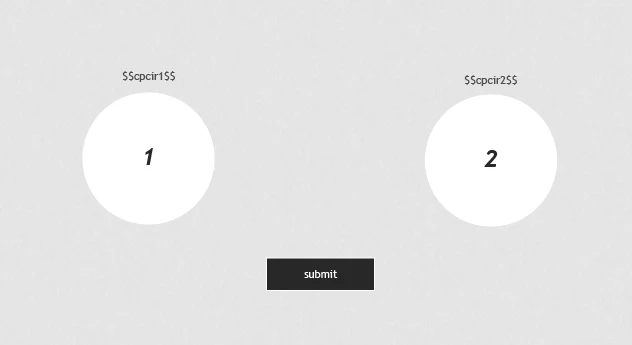

As lilybiri mentioned my naming convention made things a bit confusing.  Let me see if I can simplify what I have and what I am trying to do and give this code another shot.
This is what I have:
Objects:
'circle1' (smart shape btn, states available: normal, checked, wrong)
'circle2' (smart shape btn, states available: normal, checked, wrong)
'submit' (smart shape btn)
Variable:
cpcir1 (set to 0)
cpcir2 (set to 0)

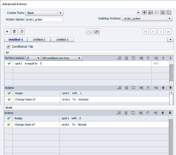

'circle1' has a captivate action of that: is seen below: ('cirlce2' has a similar action)
'submit' is controls the js action:
var1= window.cpAPIInterface.getVariableValue('cpcir1');
var2=window.cpAPIInterface.getVariableValue('cpcir2');
if (var1==1) {
     cp.changeState("circle1","wrong")
if (var2==1) {
     cp.changeState("circle2","wrong")
Again I am looking to replicate this for at least 6 times so that the user is able to click one button and that button reveal if they got it wrong.  I don't see this being able to be done easily with an advanced action if there are 6 different IF conditions in the action.  I could be looking at this the wrong way and am just trying to understand how I can best do this in the context of my main project so please let me know if I have this wrong.  Thank you all so much!

For the circle button just have it Execute JavaScript on success.
In the script window you could recreate this way.
if (window.cpcir1==0) {
cpcir1=1;
cp.changeState("circle1","checked");
if (window.cpcir1==1) {
cpcir1=0;
cp.changeState("circle1","Normal");
That is where I get confused with what you are trying to do. It appears as though your advanced action will simply toggle the circle between states. I don't see the wrong state being shown here at all. What/where are we checking for right and wrong? I feel that your "right/wrong" flag should be set elsewhere.
For example... click circle one and a variable is set or click circle two and a variable is set. Then the submit button checks the variable and does the change state.
I believe the JavaScript can make real fast work of this but the logic has to be correct.
