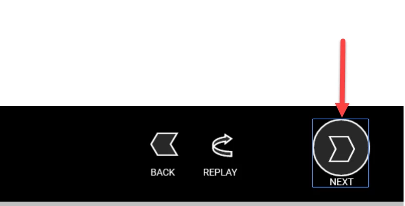

jamesr71028815
February 15, 2017
I'll add that I see tabbing working just fine in Google Chrome on windows (example attached).  However, I am still unable to see the selection box in Firefox or IE in Windows.
