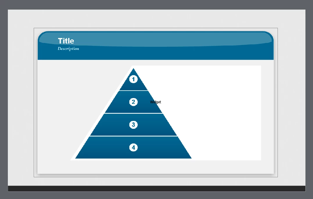

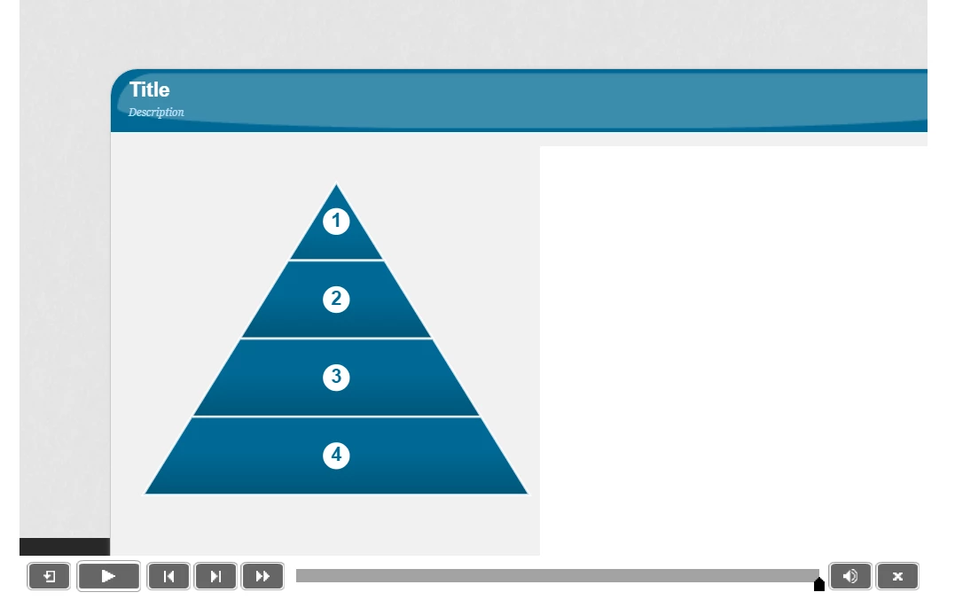

I have several interactions that preview fine in Captivate preview, but either are the wrong size or just move to the upper left in HTML5. It does not matter what I do, I cannot seem to modify the location or size of the interaction in the published output.
Has anyone run into this?

    Since I'm using a stock interaction in a blank one page course, not even changing colors or text, I'd imagine that if you have never seen the problem occur, you won't have an answer. It's not that I did anything wrong, just that it doesn't work correctly out of the box. However, to answer your questions:
    • Captivate 9.0.2.437 (this is the version the client is requesting, however it happens in 2017 10.0.1.299 as well)
    • Blank, non-responsive project. One page. Blank except for the interaction.
    • Preview in Captivate (F11) shows the interaction correctly. Previwing using "HTML5 in Browser) displays the interaction incorrectly. Also, when publishec and posted to a web server, also displays incorrectly. See attached image.
    • Many interactions, specifically I have seen it with the Pyramid Stack, Accordian, and Process Circle. Sometimes deleting the interaction and completely recreating from scratch fixes it. Sometimes not. I cannot get Pyramid Stack to work under and circumstance.
    • Browsers tested (in HTML5 preview as well as publshed output are Edge, Chrome, and Firefox.
