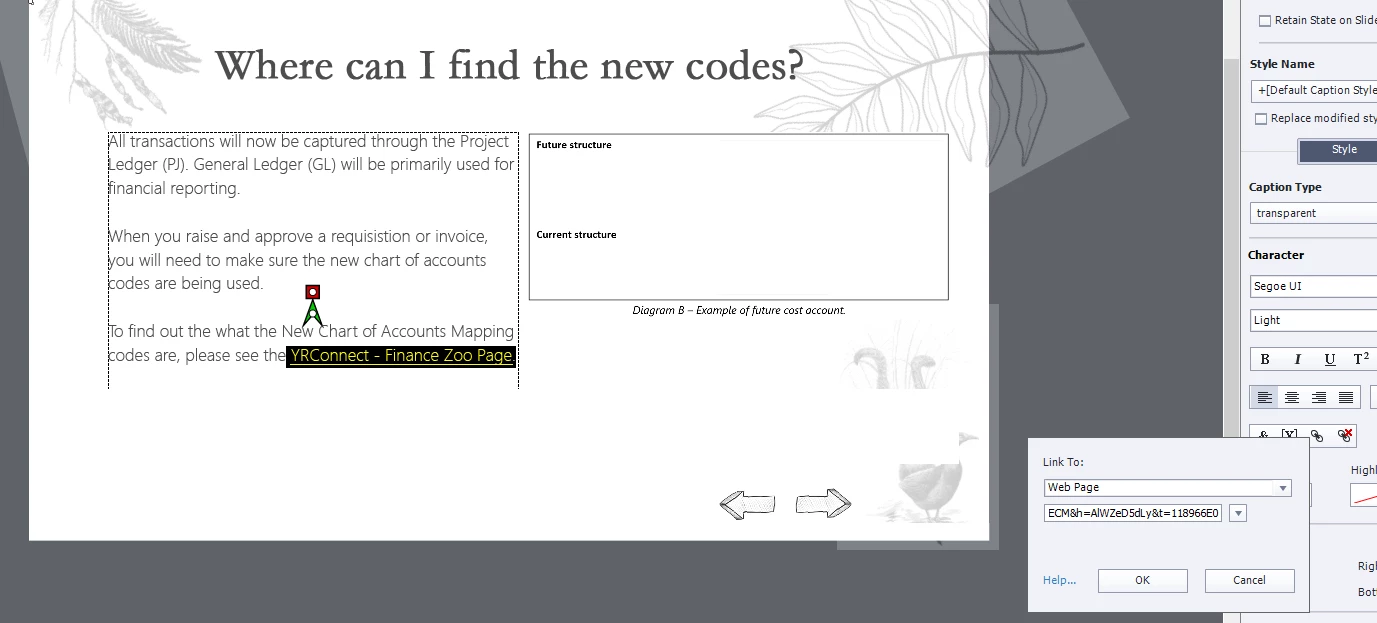

    Can you show some screenshots please? The exact setup of that 'hyperlink' in the first place.  Is it pointing to another file or to an URL?
    Jul 1, 2021 12:54 AM UTC
    hi li
    Jul 1, 2021 1:04 AM UTC
    Hi Lily, thanks for the reply.
    Here is a screen shot below. The URL is pointing to another website.
