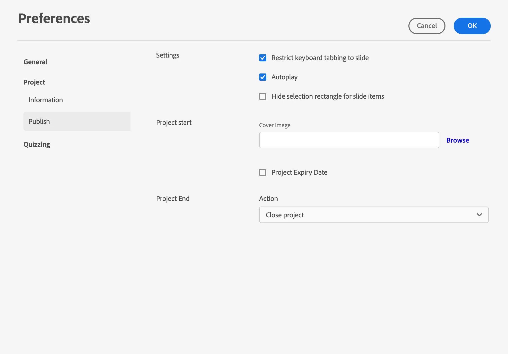

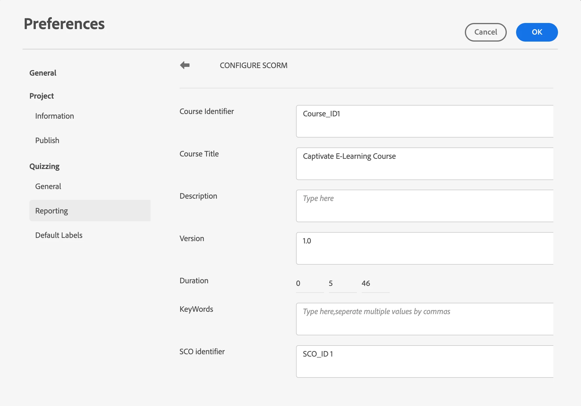

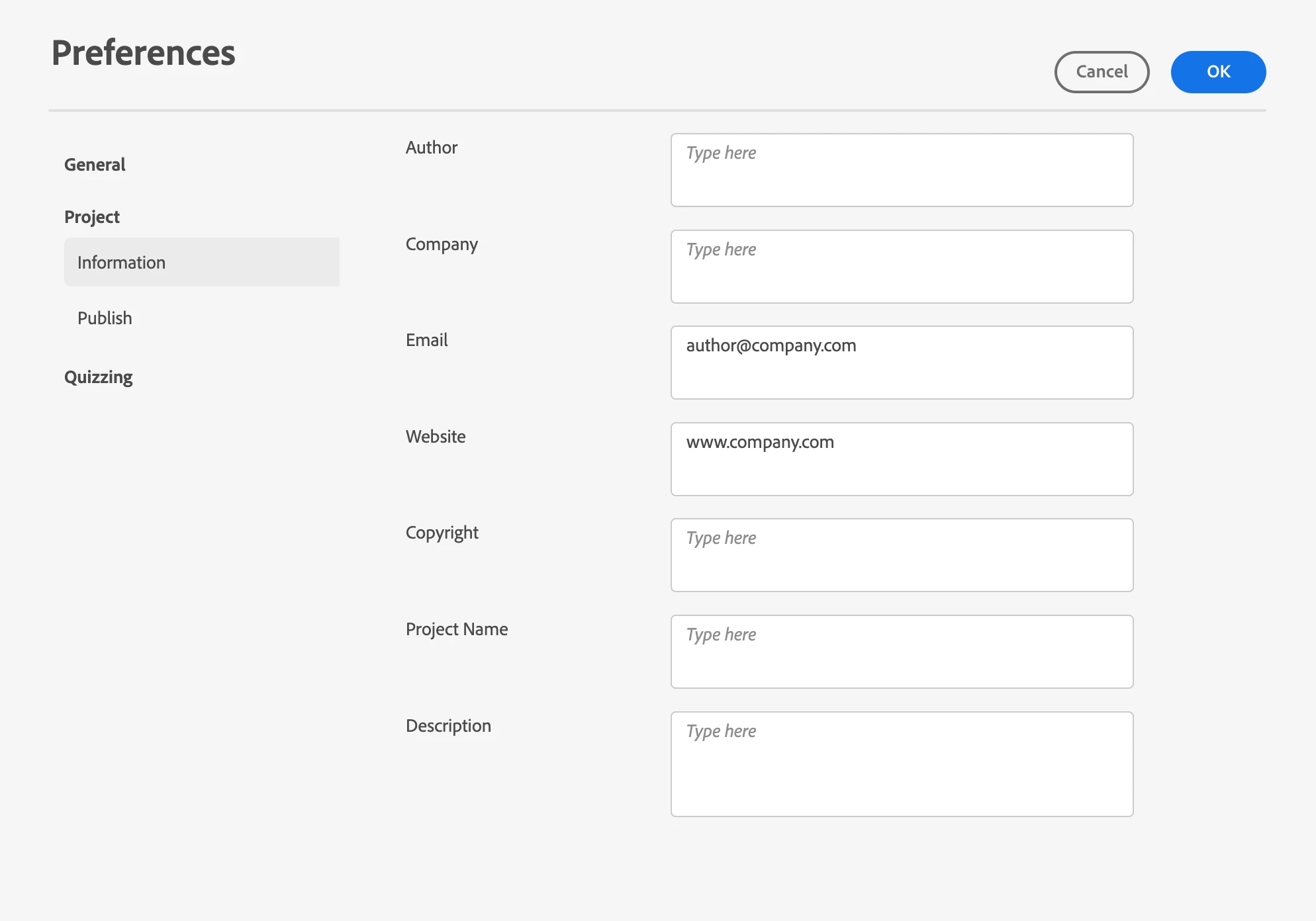

Feb 24, 2024 4:49 PM UTC
Hi Lilybiri - thanks for your response, really appreciate it!
The module doesn't have any quizzes at all - I'm asking the user to simply read content / view videos and click a 'next slide' button to naviage through the module. There are five pages plus an intro silde.
The last slide has an 'exit course' button but when I preview the module, the last last slide is visible for a couple of seconds, then the preview automatically ends and I'm back to the Cascade layout (on each slide of the module, the user must click on the 'next slide' to move on. The last slide already has interaction with the instruction to exit the course (this isn't the issue as the module wasn't registering as completed and the last slide was automatically vanishing before I added the 'exit course' button).
I have also attempted to include a question at the end of the module but the module still shows as not complete on the LMS.
- Is the fact i'm using a trial version the reason behind why the module is not 'completing' or the last slide disappearing...?
- Is using 2019 version instead of the newer version recommended as it seems to have a lot more settings available....?
As requested, I have attached screenshots of the settings available to me so you have visibility of what I'm seeing...
Thanks again for your response.

Please post screenshots of the Quiz Preferences: Reporting and Settings.
Is the last slide a score slide? Do ou have a quiz? Pausing is very annoying in this new version because lot is hidden. If you want to keep the last slide paused, add an interaction to the On Slide Enter event.
