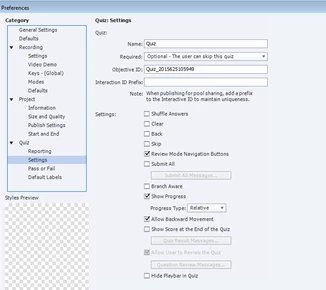

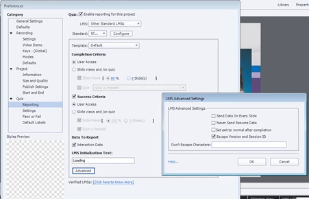

Good Afternoon, I am hopeful you can point me in the right direction.  My team and I are struggling with Captivate 9 publishing (multi-scorm).  When we publish to our LMS (LearnSoft; specifically, MeduRX) only the first module completes.  The course itself never completes and the user never receives credit for completing the course.  I have read through many, many of your discussions and I have tried almost all of your suggestions to no avail.  I will do my best to outline the relevant information:
Our completion criteria is viewing 100% of the slides (we have also dropped this down to 80% for testing purposes with no success)
Tested in Captivate 6 and Captivate 9
We publish via Adobe Multi SCO Packager 6.0 and Adobe Multi SCO Packager 9
The screen shots I will share are using Captivate 9 (and AdobeMulti SCO 9)
Settings when publishing in Captivate 9
  • Publish to My Computer
  • SCORM 2004 (we have tried SCORM 1.2 as well)
  • Screen Shot 1 - Published to HTML5/SWF
  • For image 2 (Reporting), We have also published and tested with - Completion Criteria set to Slide views and/or quiz at 80% and 100% in conjunction with Success Criteria of User Access AND (separate test) Slide Views and/or quiz of 80 % and 100% also to no avail
Image 4 (Pass or Fail) We have published with Pass/Fail Options as 0 and 10%.

    Did you try the SCORM Cloud test?

    Have you tested your course output as yet in SCORM Cloud?
    If not, I suggest you do that to get a sanity check on whether or not the issue is with your LMS and NOT the content.
