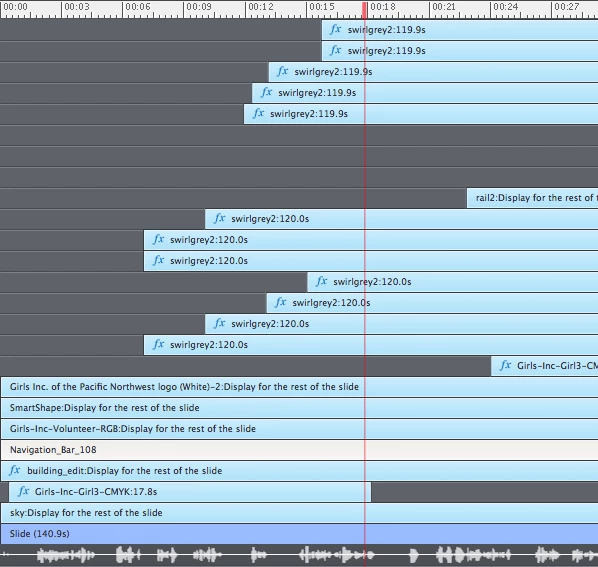

What about the grouped object called Navigation_Bar_108? Is there an object that is part of that group that might pause your project?

Can you share an image of the timeline with all objects visible? Particularly at the 17 second mark.

September 17, 2016
HI Captiv8r, thank you for replying. Here is a screen shot of my timeline.
