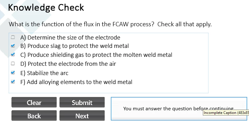

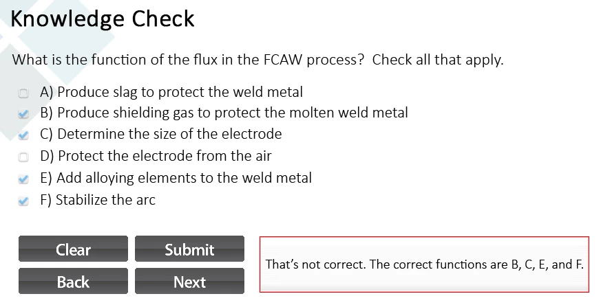

Here is a prime example, I answered all the questions that are marked correct but the question tells me I'm wrong.
Before:
After:

Themes don't usually affect whether or not a question evaluates answers correctly.  In your case it would appear that there is some kind of corruption of either the slide or the entire project.
Try deselecting all answers in Edit mode except ONE of these answers and see if selecting that same answer at runtime will get the question marked correctly.  If it does, progress through the other answers as well to see if there may be just one of these answer options that is not correctly being evaluated.  If the question will not evaluate no matter how many correct answers there are, or which ones they are, then I would have to say your project is likely corrupted.
But before confirming that, you should also try to create a new project from a blank theme and set up a similar multiple response question slide to see if ALL such quiz slides fail to work with your current Captivate installation.  If that is the case, then you may need to uninstall / reinstall and kill Preferences before attempting new projects again.
