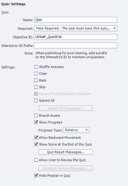

    Please take some training about Quizzes.
    Design of the default quizzes is that you lose all further attempts on a quiz slide, if you leave that quiz slide (like for visiting a content slide). There are only two situations where this can be overridden:
    1. When using Submit All in Quiz Preferences
    2. When using Remediation.
    Allowing backward movement in a normal quiz is for that reason not at all recommended.

    Got it, thank you! I removed "Backward movement is allowed" and selected "Must answer all quiz questions to continue" so that my users aren't able to navigate away to a content slide while taking the quiz. This appears to be working well for our users.

    What are the Quiz settings, especially the 'Required' option?
    Jul 6, 2017 12:17 PM UTC
    Below are the Quiz settings.  Though the Allow Backward Movement box is checked, we removed the Back button from the quiz slides.
