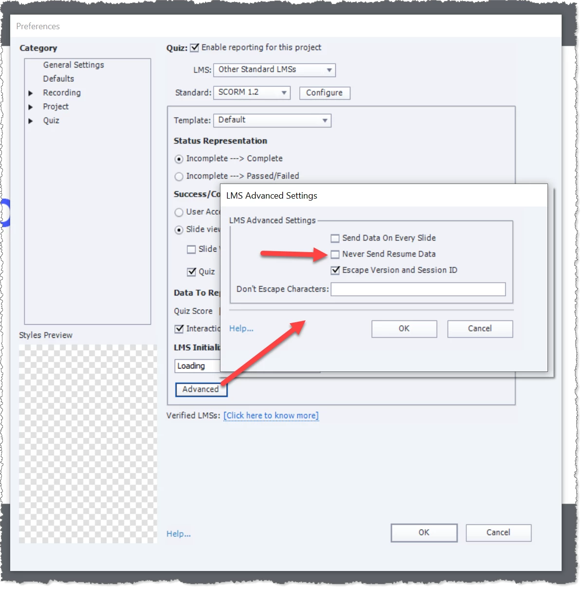

    If the user is not being returned to the slide they were on at the time they terminated their last user session then it sounds like Resume Data Bookmarking is not turned on in your Quiz Settings.
    Check under Quiz Settings > Reporting > Advanced > Never Send Resume Data.  That checkbox should be UNCHECKED if you want Resume Data Bookmarking to work.

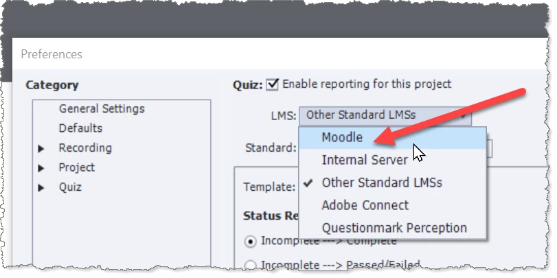

    Also, be aware that Moodle's implementation of SCORM 1.2 has some "quirks".  So you may actually get better results by selecting it in the LMS settings rather than going with the default option fr "Other Standard LMSs".
    Test and see which one works best with your LMS.

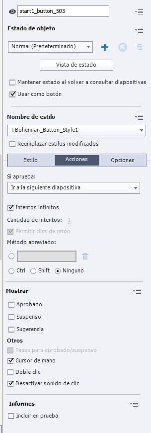

    Can it be related to the fact that I have enabled buttons to go forward and back?

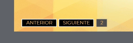

    The button options are something like this:
    Thanks.

    Is the slide that you showed above that has the Forward and Back buttons actually what the user sees when they are in Quiz Review mode?
