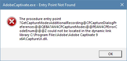

I have six Captivate files that need converting to HTML5 over the next couple of weeks (as part of a larger, longer-term project to republish a whole bunch of Presenter and Captivate courses to HTML5). Today, I was working on opening each of those six files and running the HTML5 Tracker to see which slides were going to require fixing, in order to be able to republish that course to HMTL5.
I opened the first four files (using Captivate 9 in Windows 10) with no problem. When I went to open the fifth (by double-clicking on the file in Windows Explorer, like I had with the other four), nothing happened. I tried this a couple of times. I also tried using the "Open With" option and choosing "Captivate.exe," but that didn't work either. Finally, I tried opening Captivate first, and then opening the file from within Captivate, but that just crashed Captivate.
So I then closed everything down and rebooted my computer, thinking that might fix my problem. But now, when I try to open Captivate (from the Start menu), I get the error message shown below and can't launch Captivate! (And, of course, trying to launch my Captivate courses by double-clicking on them in Windows Explorer doesn't work either.) Does anyone know what happened and what I need to do to fix this problem ASAP?

    Since you've been having so many problems I think you're NOT going to want to hear this...but...you should really be updating your Captivate version to 2019.  Captivate 9 is too old.
    Your current issue might be resolved simply by uninstalling and reinstalling Captivate 9 (assuming you still have access to install files).  But for the modest cost of the subscription I would strongly recommend upgrading to the latest Captivate version you can get your hands on.

    Thanks for responding! I had a feeling an uninstall/reinstall was going to be the answer. Upgrading is not an option right now, since that version hasn't been approved yet for use at my company. (Going through the process to get any software, or software upgrade, approved at my company is way worse than having root canal surgery. **sigh**)

    The reason I am suggesting upgrading is that once a Captivate version gets as old as yours is Adobe stops issuing patches and updates for it.  So if there happens to be some update for the Windows OS that breaks functionality or some DLL in the windows system directory Captivate uses but this DLL also gets updated in a security patch, then you could easily find yourself with an unusable Captivate version.  Adobe is not going to come to your rescue for a version as old as yours.
