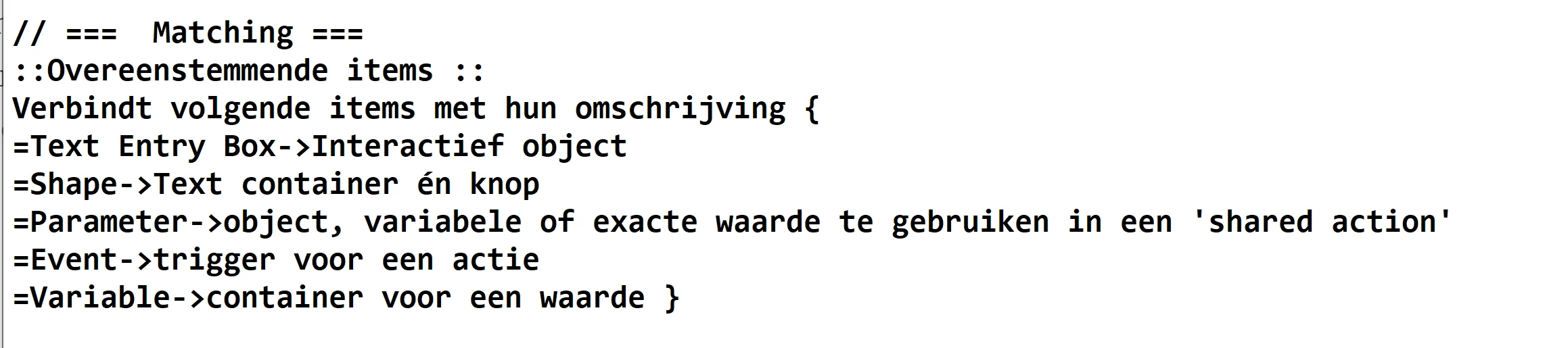

    I suspect that 'Zuordnungsfrage' stands for a Matching type of question, which has a dedicated Quizzing Master slide.  As usual I checked GIFT import, including a Matching question which you see here, into a non-responsive project in Captivate 11.5.5.553. It worked perfectly. Screenshot is in Dutch, but you can compare the syntax with yours:
    There is no way to have the question using another master slide, since they are linked to the appropriate master slide. If your GIFT syntax is correct, I would search in the used Theme, because master slides are part of the Theme.  Is the theme a packaged theme or a custom theme? If it is a custom theme, was it correctly upgraded to this version, because Themes have been improved in version 11.5 compared with previous versions?
