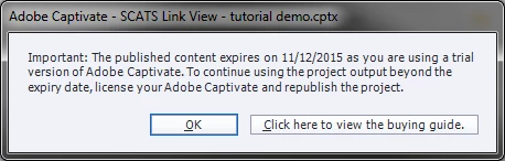

I am evaluating Captivate9 trial version for our company. Does the output generated by the trial version (both exe, and HTML5/Flash outputs) have some form of expiry, such that the output contents will no longer become viewable? There was a warning about this when I tried generating HTML5 output:
If there is indeed some form of expiration on being able to view the output after the trial period, and we purchase a short term (one month) subscription, will that remove the expiry of any generated output?

After you purchase your new license you need to re-open the CPTX project files, go to Preferences > Project > Start and End and there remove the Expiry date, then republish the content again.
