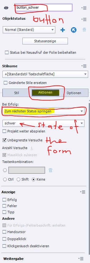

    Sure. Sorry, I have a german version.
    In my attempt I dont use any advanced action. I only use the "normal" action option on the right, when I click on the button.
    I tried to use an advanced action, but I wasn't able to find a working solution.
    (Error in the second image: With form I mean shape -> state of the shape)

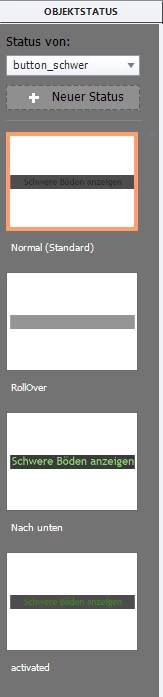

    Lilybiri
    September 1, 2017
    Can you post a screenshot of the object state panel and of the advanced
    action?
