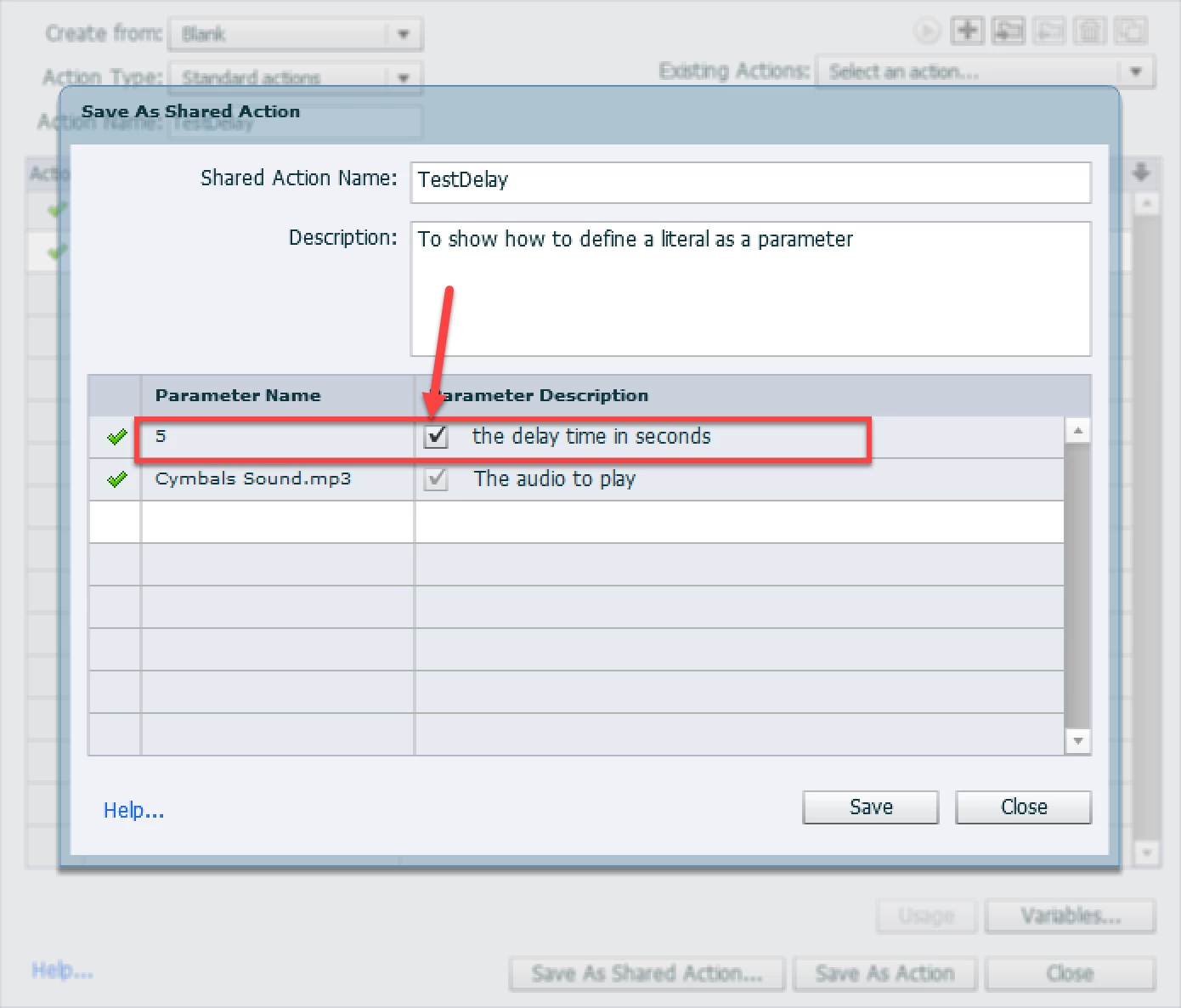

You need some tutoring on parameters for advanced actions apparently. Can you read this article:
Parameters in Shared Actions - Captivate 7 vs. 8 - Captivate blog
The delay time is a 'literal' which is what I call a 'candidate' parameter. Indicate it to be a parameter, and you'll be able to change it on each shared action.
I quickly created a short shared action, where an audio clip is played after a certain time. The audio clip is a compulsory parameter, but the literal (was 5 seconds) has to be indicated as parameter by checking the checkbox.
