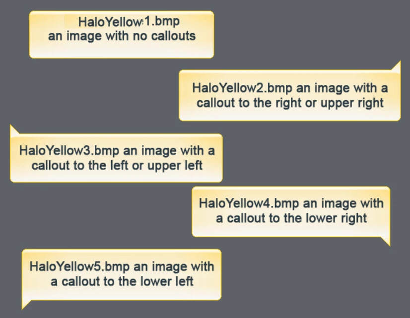

Okay, that should be a simple thing to do. Basically, a caption simply consists of a background image. In the case of the Adobe Blue caption type, the image is a blue outline with white shading. So here is how you would change this to perhaps haloyellow.
So while editing the caption, you click the upper left corner in the drop-down where it says Caption Type and choose a different type. When you do this, you are choosing a different bitmap image for the background. The trick at this point is to tell Captivate you wish ALL your other Captions to use the same background. So here is how you accomplish that.
In the lower left corner of the dialog is the "Apply to All" check box. Click to place a check mark there. Then click the button next to it that is labeled "Settings". Choose the following settings:
* Apply only changed properties
* Apply to all slides
* Apply to captions of the same type
I know you said you tried this already and weren't very pleased with the results. So here is something you might wish to check before making these changes. Click your Project menu in Captivate. In the Project menu you should see a few options. One is labeled "Autosize Captions". Make sure that a check mark does NOT appear there. The other is labeled "Calculate Caption Timing". Make sure that a check mark does NOT appear there either. Then try changing the caption and doing the "Apply to all" trick and see if your results are more satisfactory.
Sincerely... Rick

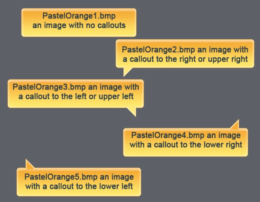

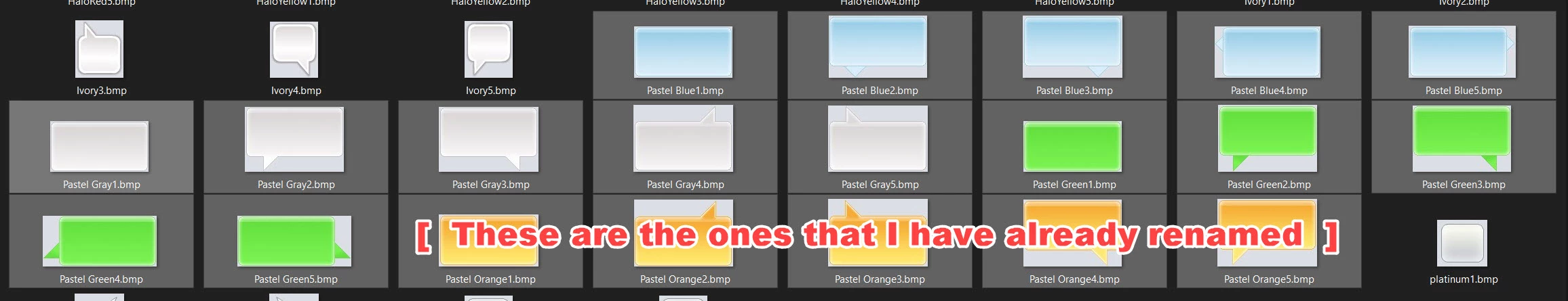

I just learned today why I have the same issue when replacing one caption style with another. The bitmap files are supposed to follow a naming convention.
If the files are named correctly, swapping them out will work fine. However, just today I discovered why I was having the same problem.
The images don't match up to the descriptions! So I reviewed the Adobe > Captivate 2019 > Gallery > Captions folder.
 In fact, ALL of the Pastel caption styles have been named incorrectly.
So, I just discovered an error that has been shipped with every version of Captivate since 2007, and Adobe has never bothered to fix it.
