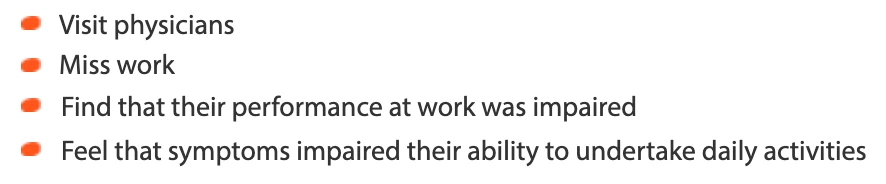

I had this exact same requirement. Initially I was making pretty complex bullet-list-looking things using images next to text captions. 8 objects to make a 4-point bullet list. Absolute nightmare for responiveness and a pain to build.
I wanted my bullet lists to look like this, to match the designs I was provided:
I devised a way to use CSS entities by injecting CSS into the <head> using an execute javascript action on the first slide of my projects, as such:

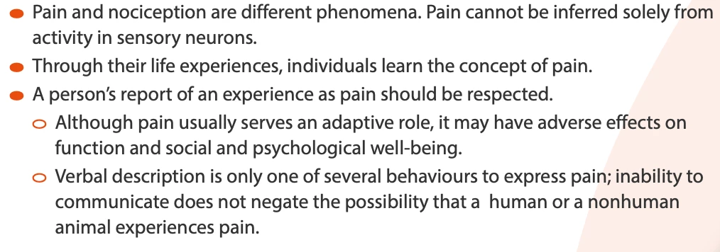

Then when adding a text caption or smart shape where you want any included bulleted list to pick up the above styles, simply add "_BLD" to its ID. The above will work with lists to 2 levels using a different CSS entity for each. I really love the 8 slashes in order to output a single slash in the code.
This should provide a start to being able to use any image you like as the bullet if there isn't a suitable entity. The outcome? Here's a bullet list using the above method, to 2 levels:
