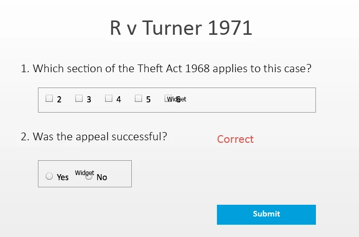

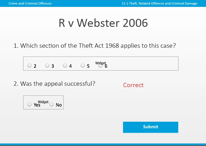

Hi all,
I've created a slide that contains 2 questions ( 1 using the CheckBox Widget and 2 using the Radio Button Widget) as shown below.

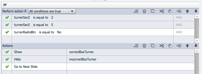

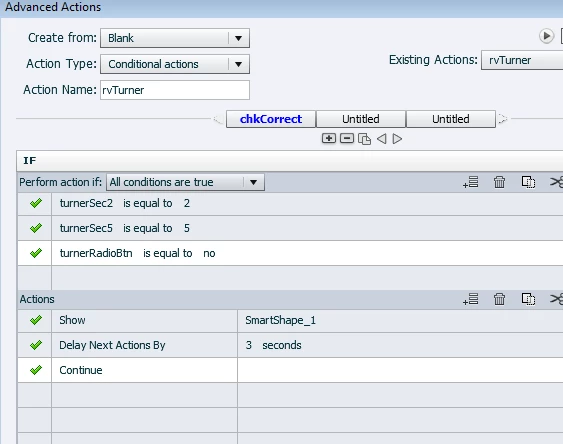

I've set up an Advanced Action (below) that checks that the user has selected the correct answers and then displays feedback (either correct or incorrect) and then advances to the next slide. The correct answers are 2 and 5 for the Checkbox Widget and No for the Radio Btn Widget.
The problem I'm having is to do with question 1 that uses the checkbox widget. Although the user only needs to select 2 and 5, they can select more checkboxes and the slide will still advance. Is there anyway that I can reconfigure my advanced action, so that this doesn't happen?
Ross

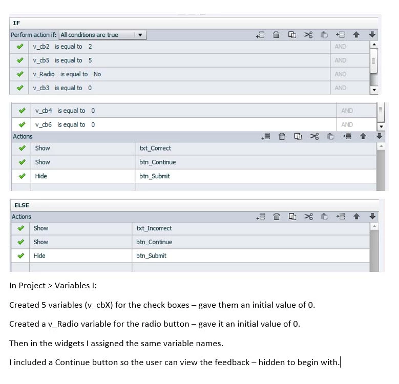

    Hi Ross
    Try this - it's the advanced action attached to Submit button.
    Donal.

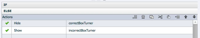

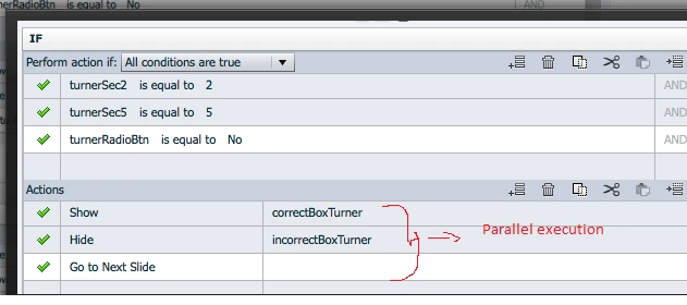

    Hi Ross,
    In response to the first issue you had, all actions in the advanced actions will start executing simultaneously. So before you see the show, hide actions, its moving to next slide.
    If you are using captivate 9, you can use delay in this scenario.
    Here is how you can use,
    provided that you hide the correct and incorrect captions directly from PI
    Rahinie

    In thinking about this, wouldn't you need to insert additional statements in the first part? Because all you are checking is to see if 2 and 5 are selected. I might think you would also want to add something like if 3, 4 and 6 are NOT selected. Then if any of those are selected, the if part would be moot and the else part would be triggered.
    Cheers... Rick

    I am puzzled because I see twice the radiobuttons widget, there is no checkbox widget on your screenshot?
    The radiobuttons interaction has only one associated variable, indeed, you label it TurnerRadioBtn and it will have the exact name of the chosen item, in this case 'No'.

    Rick, the conditional action is indeed incomplete, because none of the other variables with incorrect values may be selected, only the correct ones. Depending on the default value of those variables, either 0 or empty, the conditions to be added are:
    IF..... v_one is equal to 0
             v_three is equal to 0
             v_four is equal to 0
    If the variables are not initilialized to 0 but are empty, an empty variable has to be created v_null, and it will be
          is equal to v_null
    October 7, 2015
    Really sorry for the confusion, I uploaded the wrong screenshot from a previous slide. This is the one I should have uploaded with the checkbox widget.

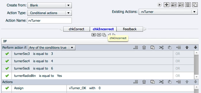

    Lilybiri - I tried amending the conditional action to check if turnerSec3, 4 and 6 are equal to 0 as suggested but I got the following error message when I published the file. I also created the variable v_NULL and tried using that but also got the same error.

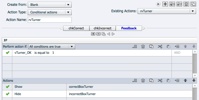

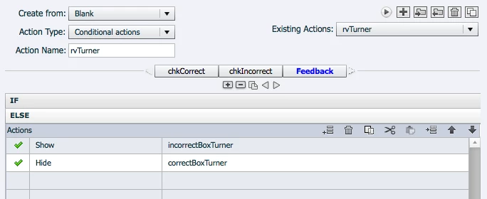

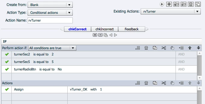

    Then, as an alternative I tried breaking the action up into 3 decision blocks as follows:
    Condition 1 - Checks if the user has selected the correct answers and if so assigns vTurnerOK with 1 (correct).
    Condition 2 - Checks if the user has selected any incorrect answers and if so assigns vTurnerOK with 0 (incorrect).
    Condition 3 - Finally checks if vTurnerOK is equal to 1 or 0 then displays the appropriate feedback.
    Upon trying to preview this interaction, I still got the same error pop-up window as mentioned before.
    Can anyone see what I'm doing wrong?
