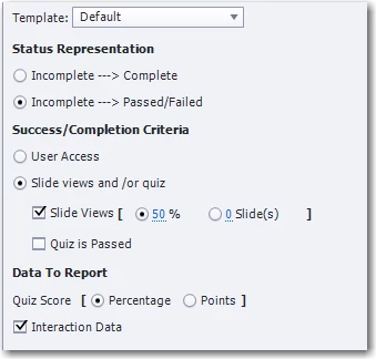

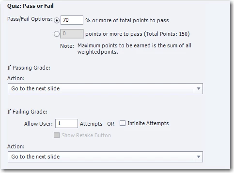

From what I've read, Captivate is behaving correctly and it is the LMS that needs to interpret the settings and display the Pass/Fail.
Here are screen shots of what I've got set:
with this

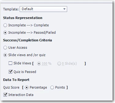

and for giggles I tried this too:
