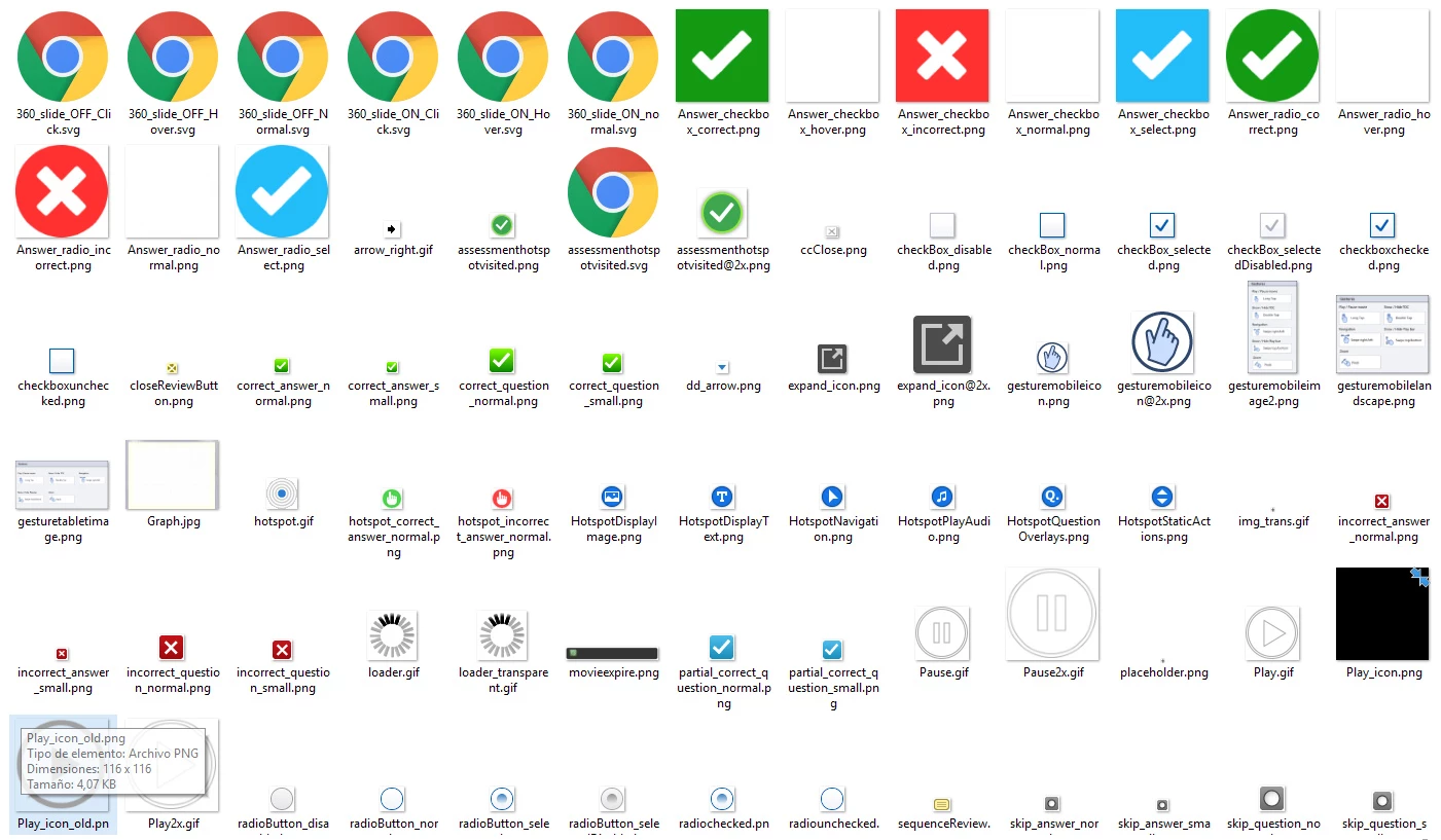

    lg80794061
    May 28, 2019 2:49 PM UTC
    I do not know if I have explained myself correctly.
    I am not referring to the specific size of a slide.
    As you know, in new projects, browsers require a click before starting the project.
    That click and its image has it set Captivate by default (attached folder with the predefined image) in its configuration. The image can be customized, but I do not know if you can create a click area for the project to start.
