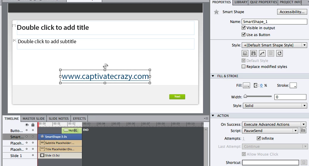

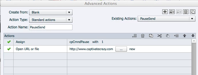

AnitaHorsley
August 22, 2013
Create an advanced action that pauses the slide and also sends the user to the site. Here is a screen shot of the advanced action.
Don't forget to attach the advanced action to the object that has the interactive object
