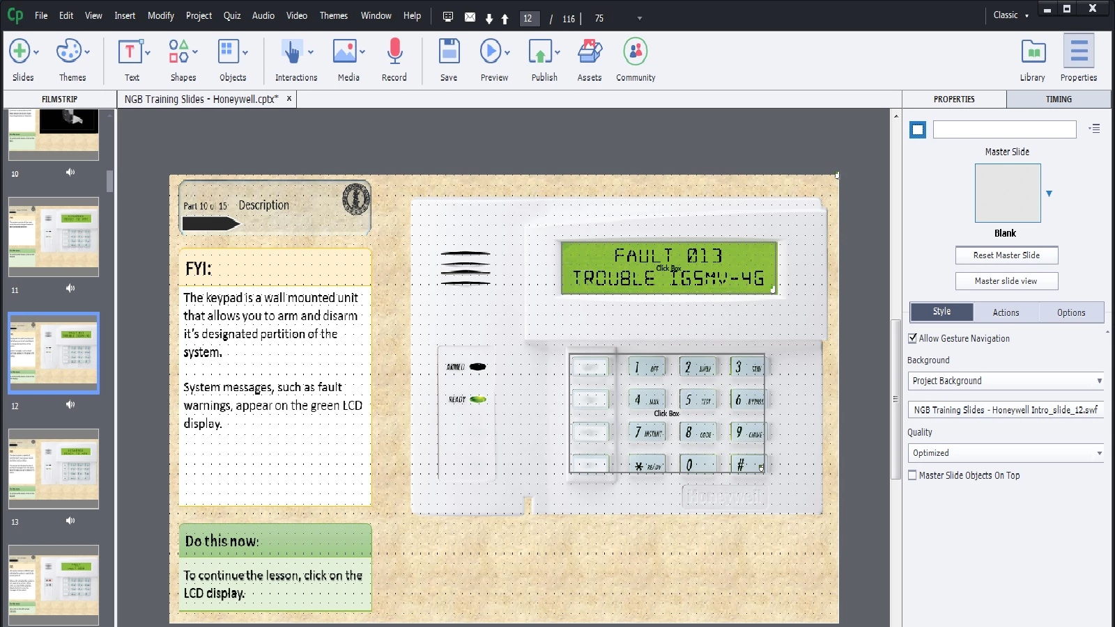

Hi,  I have an E-learning project that is almost complete.   There are wrong selection results and a right selection advances the slide.  However, I have found that if I click anywhere on the white space it advances the slide also.   Is there a way so that only the right selection advances the slide?

    I have attached a picture of one of the slides.  As you can see, there are two click box.  One that covers the display area and one that covers the keypad area.  If I click the display box it will advance the slide to the next slide.   If I click the box over the keypad, it will pause the slide and wait for a correct selection.  I have all the set at a 20 second duration.  However, if I wait long enough I can click anywhere on the slide and it will advance to the next slide.    Is there a way to stop this kind of action?

    From your instructions, why don't you just put a clickbox over the LCD display and set the action to go to the next slide.
    The clickbox should pause the slide when it reaches the end of the clickbox on the timeline. Display your clickbox for the rest of slide and make the slide 3 seconds long if you don't have audio.

    Umm, if you read my reply.  You would see that I have a click box over the LCD display and that it is set to advance to the next slide.  This is not the problem.   The problem is being able to advance the slide without clicking on either box, but just on the slide itself.
    TLCMediaDesign
    March 17, 2017
    I have a feeling you are going to need to tell us a little more about how this interaction was constructed and what actions are attached to what objects.
    Be a specific as possible and attach images if need be.
