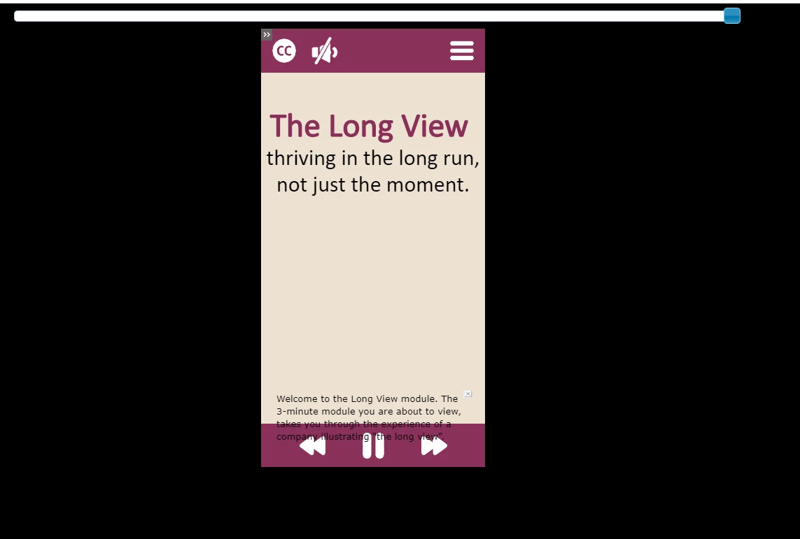

I am new to both responsive design and accessibility design.
I was previewing my module to view the slides from desktop to smartphone. Closed Captioning was on.
When viewing the slide from desktop to smartphone it appears that the closed captioning is not responsive and is moving on to the lower navigation bar. See attachment for visual.
My questions:
  • Is there a way to keep this from occurring?
  • Is there a way to keep closed captioning on for desktop through a tablet, but to hide when a smartphone view?
  • When it comes to best practice when is best to provide transcripts of audio as a PDF vs providing closed captioning?
Thanks in advance for your help! 🙂

    Please can you insert the screenshot? I don't download attachments for security (and time) reasons.
    CC is part of the skin, it is normally indeed near the playbar.

    I don't think this is a skin issue as no skin is used. I used custom buttons. They do work and you can toggle CC on and off.
