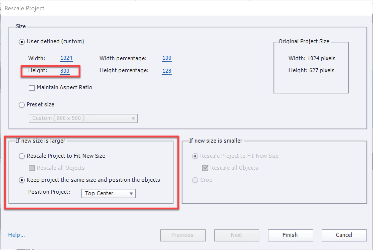

View, Rulers will turn on the rulers. You can drag guides out of the rulers, or by clicking on a certain location (like 550 px on the vertical guide). You can set up a grid as well, there are many possibilities.
In the original question you didn't talk about a software simulation, which changes the situation! I would capture the simulation (during capture you'll not see the guides). After capturing you can rescale the Project with the Modify menu: increase only the vertical size and make sure that the original backgrounds are not resized. Look at this screenshot: original size was 720px vertically, I changed it to 800px, and look at the settings under 'If new size is larger':
