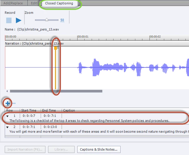

    Closed Captioning and TTS are two separate things (as LilyBiri said)... you don't need TTS to make Closed Captioning.
    If you have slide audio (one track that plays the whole time--I'm assuming this would be voice narration or something, but doesn't need to be), simply double-click on the slide audio in the Timeline and you should see a "Closed Captioning" tab.
    Once you're there, you can put markers in your audio via the plus sign and then type in the text you'd like for that portion of the audio. See below:
    HOWEVER, this only works on SLIDE AUDIO. If you have audio associated with objects or other things, Closed Captioning just won't work for those
    Your best bet in those cases would be to "fake" it via text boxes that pop in and out on the bottom that you can control.
    hope that helps!

    Yes, my issue IS that I am using non-slide audio but I also want closed captioning of that same audio speech. This is an accessilbity issue. Using slide audio will produce a duplication of the audio over a screen reader.

    Lilybiri
    July 15, 2015
    My bad, because only slide audio will be OK to have CC, but you can cheat a bit...
