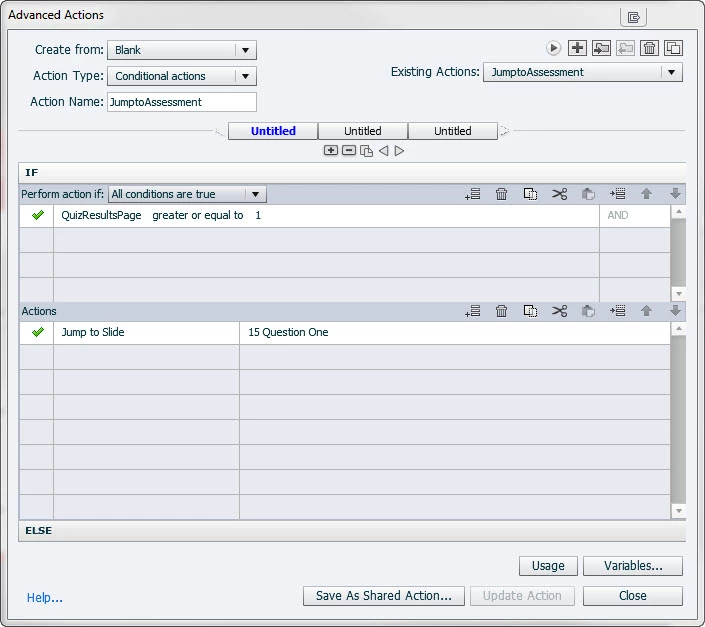

I added conditional advanced actions on the non-graded question slides:

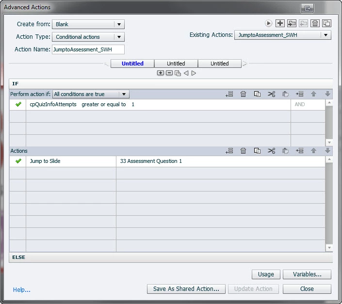

And also on the first slide shown that is not an assessment question to skip to the next set of assessment questions - which doesn't seem to do anything:

CP9 has Knowledge Check slides, why did you not use those for the non-graded quzstions? I don't know what that variable, which is not a system variable, means that you are using in the first conditional aciton.
As for skipping content slides: the system variable cpQuizInfoAttempts is set to 1 when the first attempt starts. You need to replace the operator by 'greater than' if you want the skip to happen from the second attempt. What is in the ELSE part of that action?

Thank you once again Lilybiri,
I had the wrong variable in the first conditional action, and the wrong operator in both - and added Continue in ELSE.  Works as intended now.
