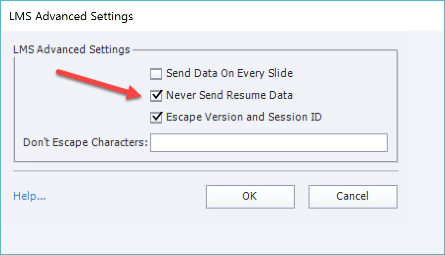

    Lilybiri
    Jan 16, 2017 6:54 PM UTC
    Is there a reason why you don't use this:
    ontarios36952008
    Jan 17, 2017 3:40 PM UTC
    If we never sent the resume data, then learners wouldn't be able to start up where they left off.  Granted, checking this would solve the other issue, allowing learners who completed the course to return to the course start for a refresher.
