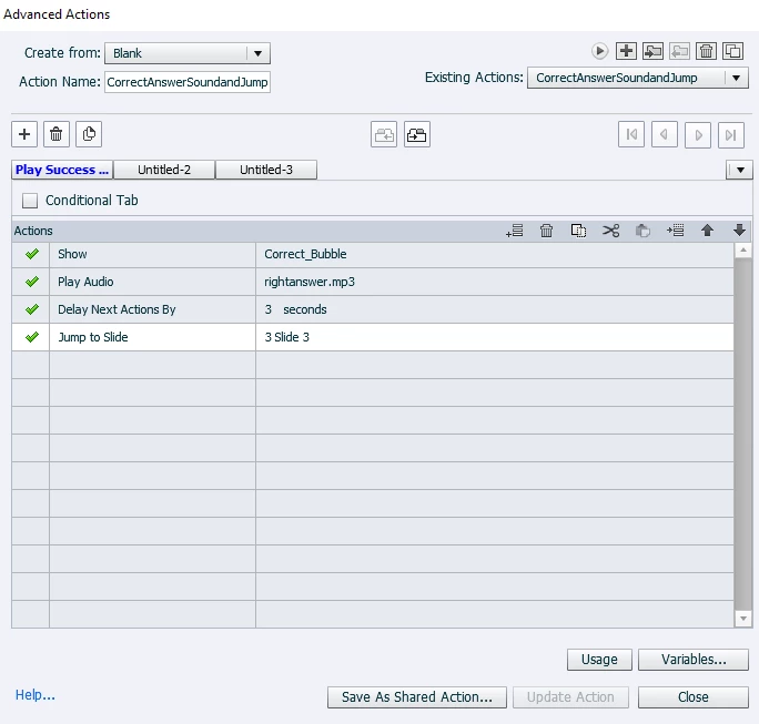

The Advanced Actions I'm using to make this happen are extremely simple, and this one is used on all question slides (Slide 3 is the main question selection board):

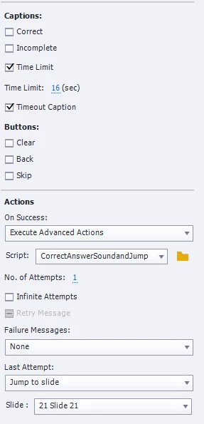

I've checked every parameter that is being used - No. of Attempts (1), Time Limits, Slide Timing, everything is identical on all question slides, and this happens in a totally random manner, I can't duplicate it on purpose at all.
Under the Quiz tab, the only difference on each question slide is which Slide they are sent to on the Last Attempt: Jump to slide (which is always the next slide in the deck with the detailed explanation).
Since there is a 3-second pause so the user sees the "Correct!" graphic, I thought maybe it was a timer issue, so I tried waiting until the countdown reached 2 seconds or less to give a correct answer (in case that pause crossed the page's time limit), except it worked as expected, so it wasn't that.  Also, this happens when there is plenty of time left.

Advanced answer option is only available for one type of questions: MCQ with one correct answer. However I have serious doubts that this could solve the problem. It should be perfectly possible to use the Success and Last Attempt actions of the quiz or KC slide.
You use an image for the Correct bubble, which is timed for the rest of the project since you have only one ID for that bubble. Why did you not use the feedback success shape and fill it with an image on the quizzing master slides? It would avoid the need for the Delay command which can be tricky. I will not elaborate on that too long. First of all I would like to see an image of a quiz slide and its timeline.

Looks like getting rid of my persistent 'correct' bubble and instead using an image in the success shape on the the quiz master slide did the trick, it (as you mentioned) allowed me to simplify my navigation on the questions to simple "Jump to Slide" and get rid of the Advanced Actions there.  I don't know how I missed that you could use an imported image in the success shape, but I did.  Thanks.
