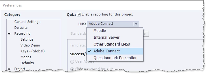

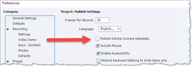

    Two suggestions:
    1. In Preferences, turn on Adobe Connect Metadata.
    2. In Quiz > Reporting, Don't use Internal Server Reporting as this is nothing to do with Adobe Connect. It is intended for use where you have a PHP compatible web server and are using the PHP pages supplied with Captivate.  Use the Quiz Reporting option for Adobe Connect.
    That should get you closer to your goal.
