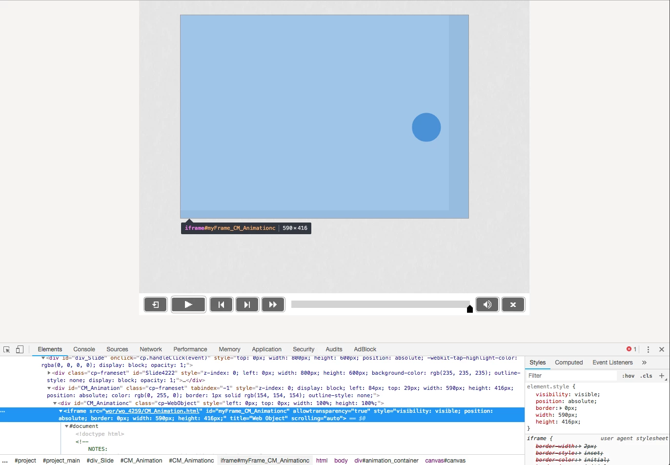

    Preview the project in HTML5 browser and use the developer console to explore the resulting HTML.
    If you nameed the animation object "Animation01" in the properties panel, the resulting iFrame id is usually "myFrame_Animation01c".
    So the javascript would be "document.getElementById("myFrame_Animation01c").contentWindow.exportRoot.play();"
    This can be on a button or as part of an advanced action, or anywhere you can run a javascript in Captivate.

    if you are using Adobe Animate, And know the name of the iframe that is created by Captivate, one line of code to stop:
    document.getElementById($(this).attr("id")).contentWindow.exportRoot.stop();
    to start:
    document.getElementById($(this).attr("id")).contentWindow.exportRoot.play();
    go to and play  frame 300
    document.getElementById($(this).attr("id")).contentWindow.exportRoot.gotoAndPlay(300);
    Basically you are targeting the iFrame content created for the web object (animation), exportRoot is a method to access the animation from the document level.

    How do I get the name of the iframe? I checked in the folder "wor" created in the Captivate output folder but could not find it.

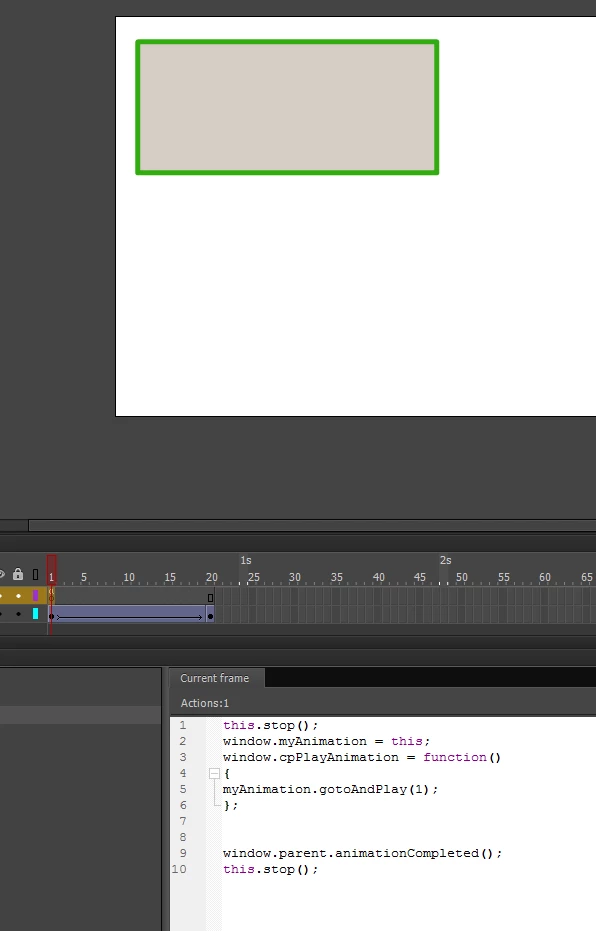

    I ended up exporting from edge animate as an HTML5 file and using javascript to control the animation by calling a function in Captivate that would start the animation when a button was pressed. The only thing I was not able to figure out was how to get a transparent background in animate when exporting.
    Animate file is loaded into Captivate as HTML5 web object.
    In Captivate:
    window.animationBegin();
    if (audioPlay == "true"){
    window.cp.show("sec01_11_speakerOff01_btn");
    window.cp.hide("sec01_11_speakerOff_btn");
    window.currentAudioButton = "_speakerOff01_btn";
    } else {
    In Javascript:
    function animationBegin() {
    document.getElementById("myFrame" + animationControlID).contentWindow.cpPlayAnimation();
    window.cp.disable(slideName + "_playAnimation_btn");
    alphaChange("down", slideName + "_playAnimation_btn");
    On main timeline in Edge Animate (stops the animation and causes it to play when button selected in Captivate):
    this.stop();
    window.myAnimation = this;
    window.cpPlayAnimation = function()
    myAnimation.gotoAndPlay(1);
    (tells Captivate that the animation has stopped)
    window.parent.animationCompleted();
    /* Stop at This Frame
    The  timeline will stop/pause at the frame where you insert this code.
    Can also be used to stop/pause the timeline of movieclips.
    this.stop();
    This will also allow you to control your sound. Hope this helps.

    I am trying your solution in a Captivate file with an OAM from Adobe Animate CC.
    In Animate CC I have the simplest tween (see the image).
    I enter the code in the first frame of the Actions layer.
    Then, where should I add the code exactly in Captivate.
    You mention "In Javascript" - do you mean to a button that would execute a JavaScript?
    In that case the first bit that you call "In Captivate" should be hooked to Java Script OnEnter of the slide?
