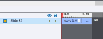

Can I see the timeline of a question?  And can you tell the exact version number you are using (Help, About Captivate).

Jul 3, 2019 7:55 PM UTC
