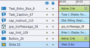

I don't understand: a button is triggering that action (could have been a simple action, why use a conditional action?). Are you using that action for a number of buttons on the stage? Maybe it would clarify if you showed a screenshot of the stage and the timeline.
