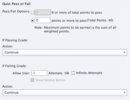

Don't know if any of this has anything to do with my issue, but I attached screen shots of my settings.

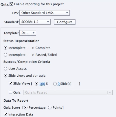

Success/Complete Criteria: I unchecked "Quiz" since I only wanted Cp to take slide views into account.
(the support told me to check "Incomplete--->Passed/Failed" + uncheck "Quiz". That did not work, so I re-checked "Incomplete--->Complete"

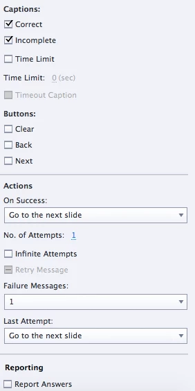

Captions: I checked "Incomplete" since I didn't want the learner to skip to answer the questions. I just wanted the learner to get correct or incorrect feedback. I deleted the "Buttons" and kept only "Submit". To continue the learner could click anywhere on the slide.

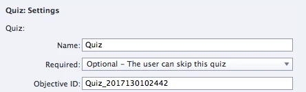

I have "Optional" as standard. Even though the learner cannot proceed without answering every question, since I deleted the inbuilt buttons. Does this has anything to do with the issue? Do I have to put back the inbuilt Next button?

The Continue button on the score slide, the Submit button on the Quiz slides are essential. I read that you deleted a lot of Inbuilt buttons. That could cause issues, never delete embedded objects on those slides: those are the objects that do not have an individual timeline, they have functionality built in. Some can be unchecked in the Quiz Properties (as you did for Clear, Back, Next) and that is fine. But neither the Submit, nor the Continue button should be deleted. The tow actions (Passing/Failing grade) ae triggered by the Continue button which you deleted.
If you don't want to show the Score slide, no problem: Hide it.
You require 100% Slide views? Are you sure that all slides will be viewed totally?

Normally, 100% Slide views are not a problem for me and in this current course they have to view all slides. However, they might not view the whole slide with all frames, but I understood it as frames doesn't count that way in CP8.
What do you suggest as a standard?

There is no easy way to set the Continue button back, try to uncheck 'Show Score' in Quiz Preferences, then check it again.

Depending on the LMS, I am bit hesitating to use 100% slide views as criterion. Even though your quiz is not important, I will often add one scored button (at the end) to be clicked and use the score of that button as extra criterion. But since you didn't have issues with your LMS, this is perhaps superfluous.
