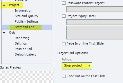

    Just a thought:  You may want to check your project End options and make sure it's not set to "Close Project" because sometimes it will close out the window before the course has had a chance to report back to the LMS.
    August 17, 2017
    It is set to Stop Project, not Close.  Should I change it to something else?
    August 17, 2017
    Nope... that's perfect.  Must be something else going on.
