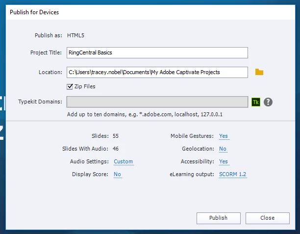

I am trying to convert some courses to responsive/HTML5 format, and when I publish the zip files, the SWF file is still contained within the folder. Therefore, it publishes in Flash format when I upload to our LMS. I have converted other courses without this issue so I can't figure out what is different about these other courses.. The output in the publish setting shows as HTML5 and previews in the web browser correctly. Any ideas?
I am using the 2017 version of Captivate. These files were originally created in version 9, but again, it converted correctly in similar instances.

Could you post a screenshot of the Publish dialog box? I suspect you are publishing to both SWF and HTML5.

That does seem to be the case given the output, but when I go to Publish it only shows HTML5, and I cannot change that

This is the dialog box for publishing a responsive project, which is only to HTML5 because only normal (blank) projects can be published to SWF. Where do you see the SWF?
OK, must not have read well, have to double check what happens when upgrading an older non-responsive project to a responsive project. Did you delete the former published files, or publish to another location?
