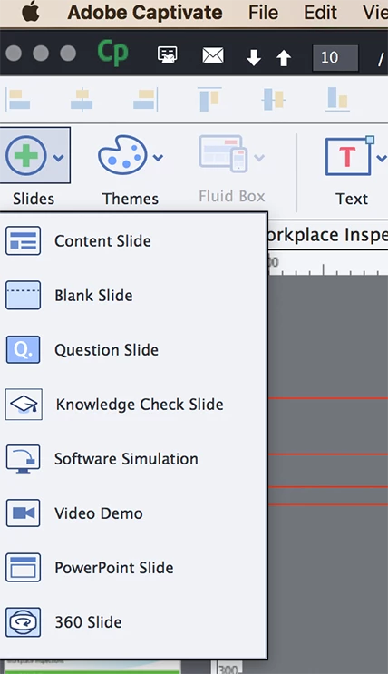

Just watched webinar from Adobe, was great.
Can you add VR slides to a standard project and if so, can you view these slides in the course using the browser and not a VR headset?
If so, what are the steps to make it happen?
Correct answer Lilybiri
Yes, look under the Slides button for '360 image slide'. They can always been viewed in a browser, kist like a >VR project.

elearningbuilder11
September 19, 2018
Thanks Lieve, I see it at the bottom

Lilybiri
LilybiriCorrect answer
September 19, 2018
