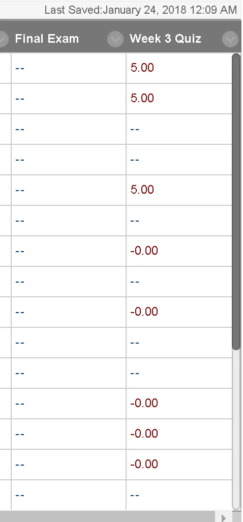

I've seen that there has been discussion on issues with logging scores in an LMS.  I've ran into this issue as well and am looking for a solution.  I am using Blackboard 9.1 with Cp 2017.  When the students take the quiz, only 5 of the 25 points are recorded even though the student completed all successfully. I've outlined the steps I take below and the results the students receive.   Any suggestions???  My work around is to go in an manually update the grades.

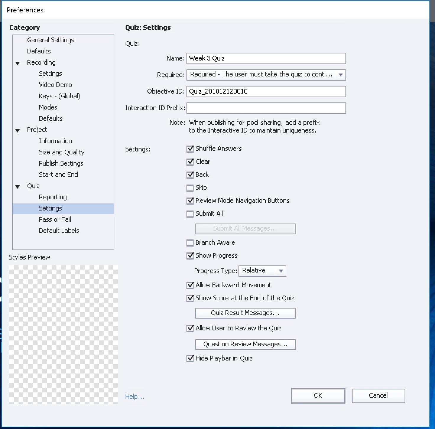

1. I create my presentations w/ quizzes in CP 2017 with the following quiz settings:

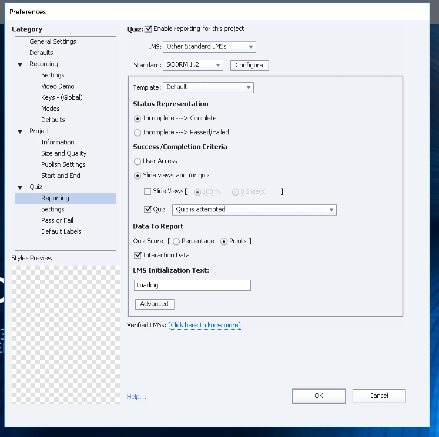

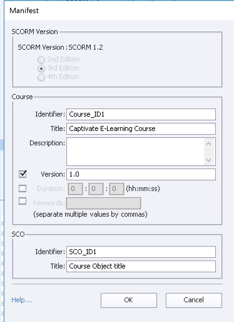

2. Then I set up the LMS in CP 2017 as follows with points selected:

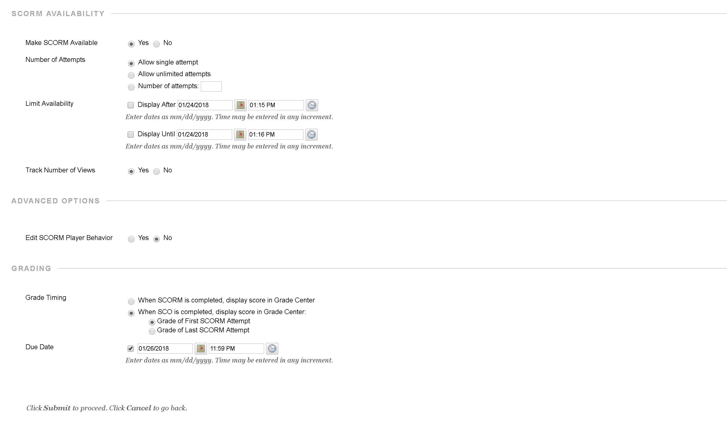

3. I import the SCORM into Blackboard with these settings - there are 5 questions @ 5points each to a total of 25 points for the grade book item

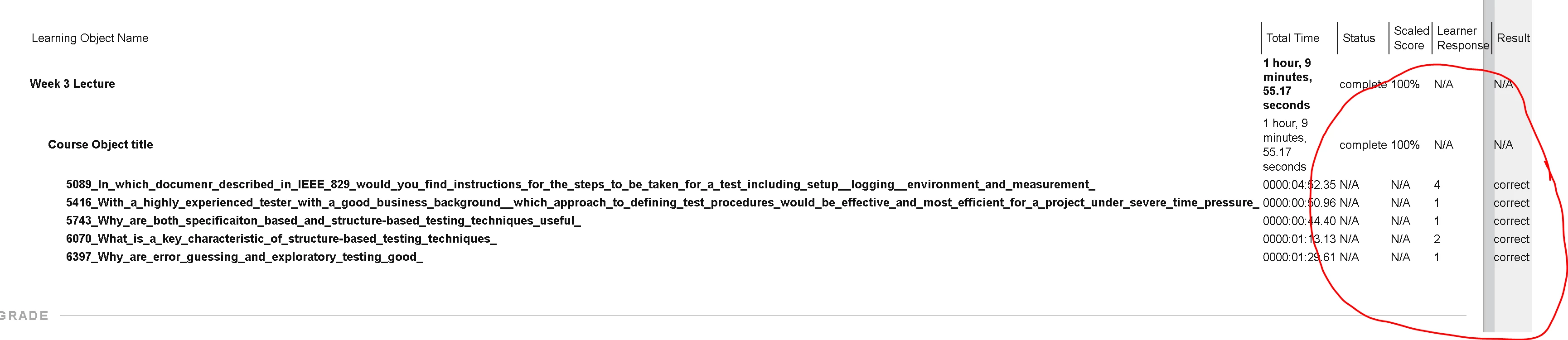

4. When the student takes the quiz, only 5 of the 25 points are recognized even though the student answered all correctly.
