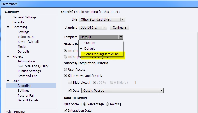

Erik Lord
Jun 26, 2013 3:02 PM UTC
To add slightly - 'send on every slide' is usually the best option - it allows the LMS to 'keep up' with the current progress, especially for bookmarking...especially if the lesson > LMS communication gets interrupted at any point, the LMS has the 'latest/current' status.
However, the 'send on every slide' has caused problems where there may be a quiz lesson - say 35 questions - and the user is flying through really fast. The lesson/LMS may not be able to keep up, resulting in incomplete data being stored when the user closes the lesson (even if the lesson itself says 'done/passed/xx%', that info may not have made it to the LMS yet).
SO in those types of lessons, 'sending data at end' generall works better.
-E

I don't see an option for 'sending data at end'.
