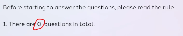

My calculation by using Expressions doesn't work at all - the result shows "0". The purpose is to display the total number of questions before the actual Question slide.

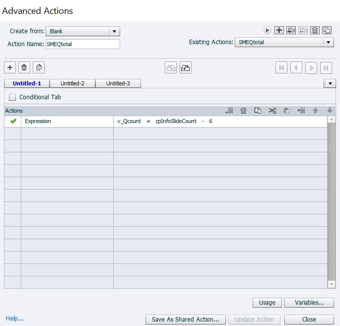

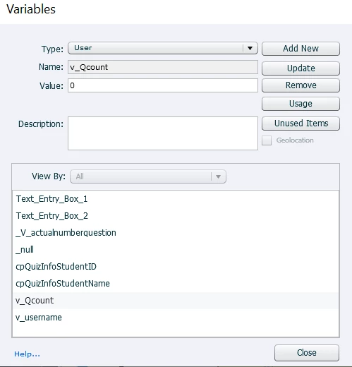

Varialbe - v_Qcount
Adv Actions - "6" is the total number of those non-question slides

    I intend to tell users how many questions in this assessment. That's why I use <"cpIntoSlideCount" - 6>..
    note: 6 means the total number of instruction slides and the result slide
    You need to trigger it on Enter for the first slide. For more flexibility I would not use the literal 6 but the system variable cpQuizInfoTotalQuestionsPerProject:
      Expression v_QCount = cpInfoSlideCount - cpQuizInfoTotalQuestionsPerProject
    How did you test it? If this is a non-responsive project use only F11, Preview HTML in Browser. That is not needed for a responsive project, and you will only find that option when you have upgraded to 11.8.1. BTW the Preview Project in that most recent version is identical to F11, no difference.
