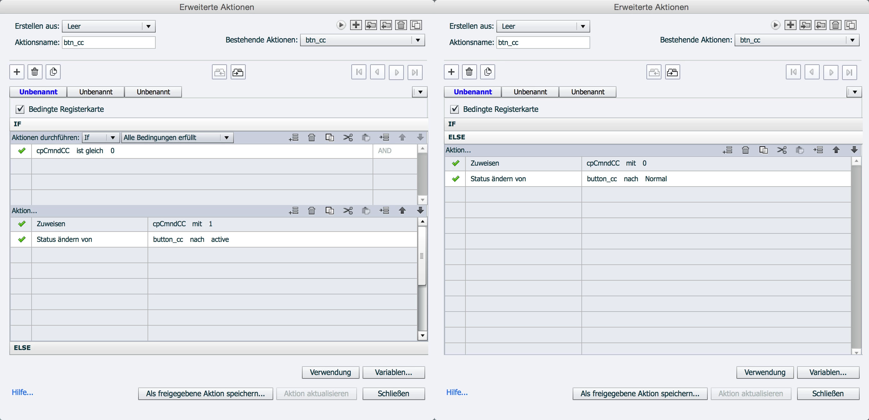

I tested in Safari and FireFox in HTML5 and used an advanced action.
I'm using a SmartShape which is visible for the whole project.
It only does work for me if the player skin is activated.
My action pretty much as simple as possible. I tried assigning 1 or 0 and toggling the variable, I attached an screenshot in this post.
So I guess porting my project over from 9 to 2017 could have caused this problem ... I'm going to try this now in an empty project.
