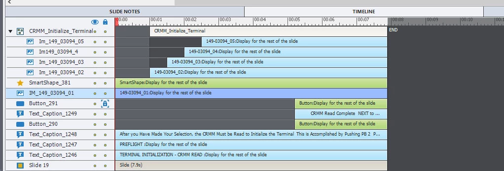

I have a graphic and button on a slide.  When the button is pushed it is suppose to show a group of graphics spread out on the timeline to simulate a screen being initialized and showing a sequence of screens.
When I go to preview next 5 slides the original graphic doesn't show, so I can't press the button to see if the grouped graphics will appear and work.
Thanks in advance.

Susan, are you aware of the fact that the Preview method which you mention is showing SWF output, if this is a non-responsive project? Do you have same issues with Preview HTML in Browser (F11)?
Which action do you use, and can you show a screenshot of the Timeline?

I haven't been using the HTML5 browser because this project is full of swf animations that I'm trying to replace with Captivate.  The HTML5 preview always fails.  This is a non-responsive project.
I have a group of slides that are suppose to appear after a button is pressed in the same location as the orginal screen shot.  So far the original screen doesn't appear so you can push a button and make the grouped slides appear.
I found a way to make the HTML5 preview work.  I hid the other slides.  Now a new issue.  When I press the button the screen changes but doesn't show each of the slides in the group as they are timed out.

Have serious troubles to understand... You talk about 'slides', but I see only one Timeline for one slide. There should be a button, suppose it is that SmartShape (greenline) but it has o pausing point. I asked to see the action tirggered y that button?
