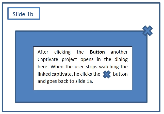

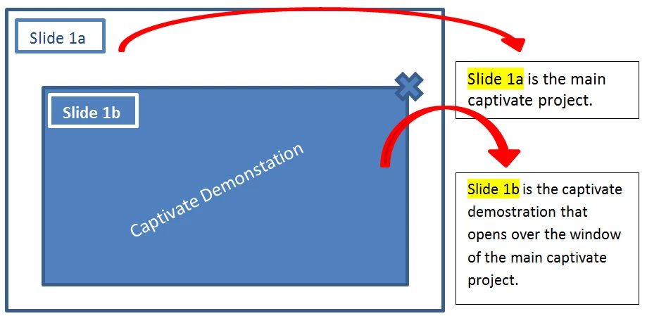

I want to link cptv projects by using  pop-up dialogs on the main captivate project, but I don't know how to do it.
I know that this idea can be implemented on Captivate, since I saw it on another online course.
Example:
  1. The hyperlink of the button on slide 1a opens a pop-up dialog that has embedded another captivate project (see step 2).
2. When the user finishes watching the embedded captivate on the pop-up dialog,
he then closes the dialog by clicking X button and goes back to the main captivate project (i.e. slide 1a.)
3. What the user sees after closing the pop-up dialog.
Do you possibly know how I could do that? Does it involve advanced actions?
Thank you a lot in advance.

Hi Lilybiri,
No I don't want them to read the pop-up before the other project opens.
I want them to:
1. Click a button on the main captivate project (slide 1a) to open a pop-up dialog with a captivate demonstration in it (i.e. slide 1b).
2. I want the pop-up dialog (i.e. slide 1b) to open over the window of the main captivate project with the blue round button (i.e.  slide 1a).
3. When the user finishes watching the demo I want them to able to click the Close button of the pop-up dialog (see slide 1b) and go back to the slide of the main captivate project with the blue round button on it (i.e. slide 1a).
(On my previous post by "Landing page" I mean the 1st slide of the main captivate project).
I hope the above make sense.
Thank you,
Iasmi
