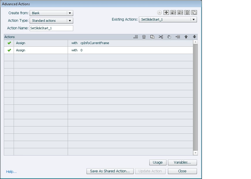

I had used your micro navigation blog as a starting point for what I was doing.
The issue ended up being a corruption in the variables. I think. See the screen shot below. The Advanced action has lost some assignment information. What's incredibly weird is that the swf output dosent haver an issue, but the html output does.
Thanks
