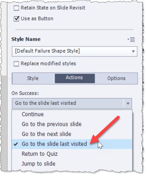

    This variable is generally used where you are building an interaction and you want to use the Go to Last Slide Visited action (as shown below).
    So, unless your user has just jumped to a specific slide FROM another slide, perhaps this variable doesn't get populated with a value.  Maybe check if that is the case.
