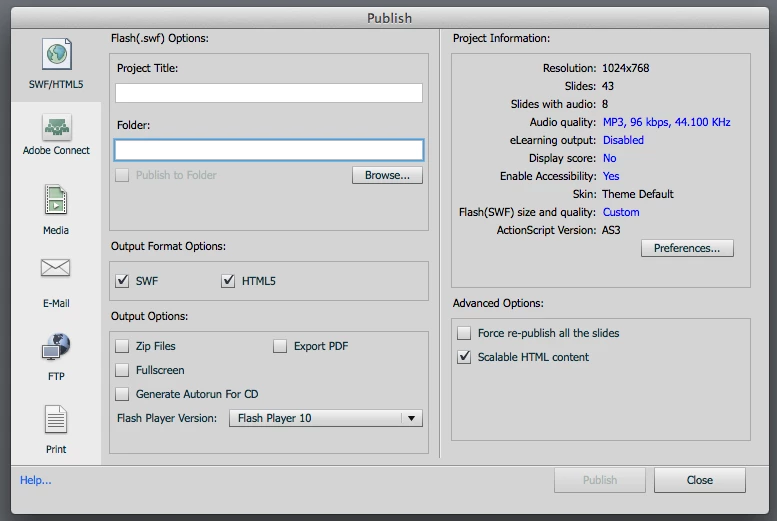

I am in the process of testing my Captivate 6 project in various web browsers including IE7. I have published the project consisting of slides with text, images and videos (inserted into Captivate as f4v) in SWF and HTML 5 format with the following publish settings shown below. There are no quiz questions included in the project.
The project plays fine in all browsers including iOS Safari on iPad except for IE. In IE7, the Adobe Captivate warning message appears stating that the browser does not support some of the content in the file that you are trying to view and suggests using IE9+, Safari 5.1+ or Chrome 17+/ The HTML 5 tracker does not show any errors in the project file. The errors that appear in IE include the following:

Thanks for your message. In my publishing settings I have selected SWF and HTML5. Does this mean that if the brower the end user is using to view the project does not support HTML5 that it will use the SWF version of the output instead? If so, do you know why IE7 is not doing that in this case?
I just re-published my project only in SWF and was able to successfully get it to play in IE7.
