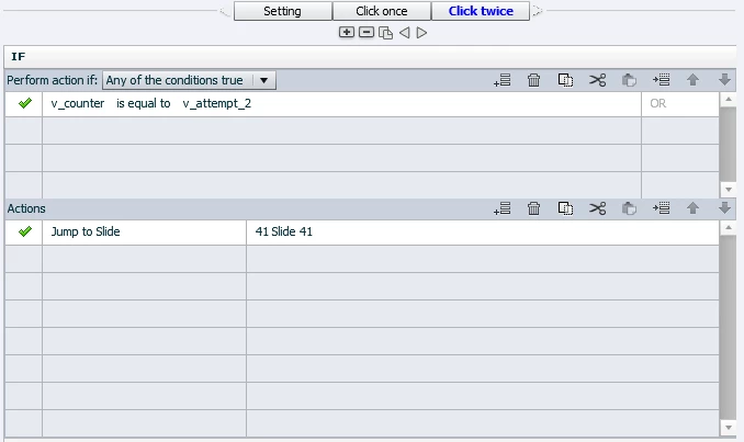

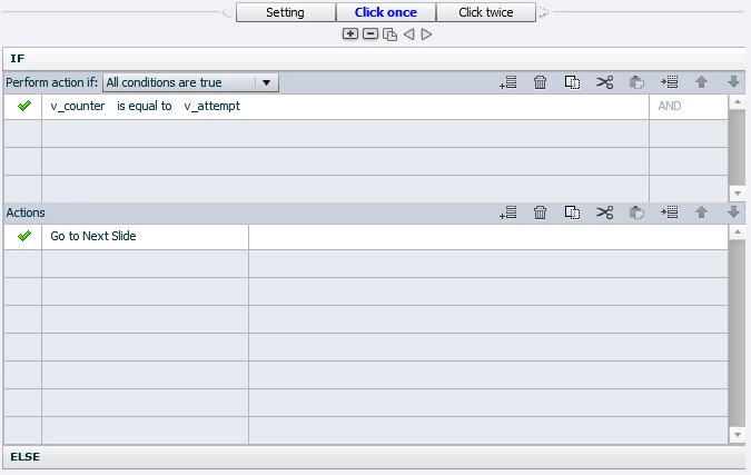

VivintAuthor
July 20, 2015
So I have 3 decision blocks now.
  • v_counter has a value of 0
  • v_attempt has a value of 1
  • v_attempt 2 has a value of 2
Once again, the "Click once" decision block works well, but it's not registering the second decision block. I'm trying to apply what you guys have told me, but I'm utterly confused
