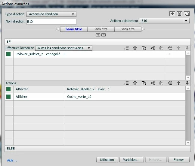

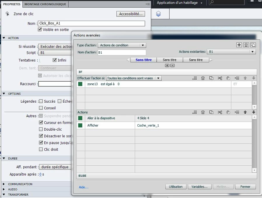

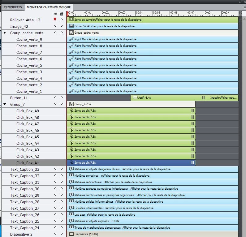

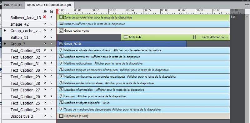

Hello everyone,
I created with Advanced Actions click boxes, once clicked all areas, my next page button appears correctly on the slide
I did the same principle with rollover slidelet zones, the next page button does not appear ..
Minidiapo first overview: (the above pictures are in French, so sorry) 🙂
Condition: If rollover_slidelet_1 is 0
Action: Assign rollover_slidelet_1 is 1
coche_verte_10 display (overview display)
2nd minidiapo overview:
Condition: If rollover_slidelet_2 is 0
Action: Assign rollover_slidelet_2 is 1
Show coche_verte_11

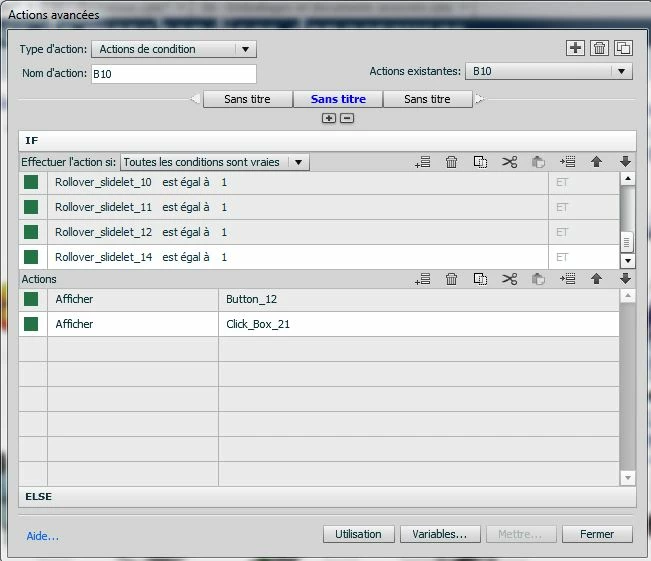

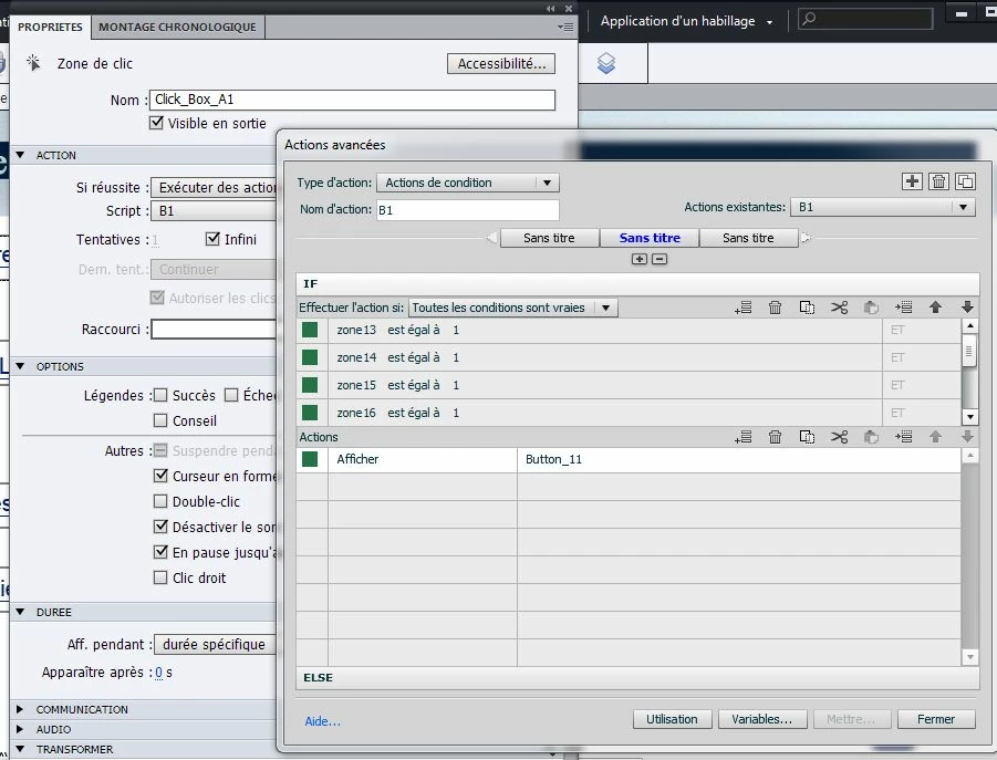

same on 13 rollover minidiapo
second page:
If all are rollover_slidelet 1
Action: Display button (next page)
click display area (go to the next slide)
info entries on each script created.
After scormé and placed my LMS module, not only the next page button does not appear, but the green check marks appear or not, it's pretty random.
Are Has there things I forgot to do?
The result is different depending on the reading of the slide: playing on .cp, playing on .exe, playing scorm on the films, do you have the same results?
