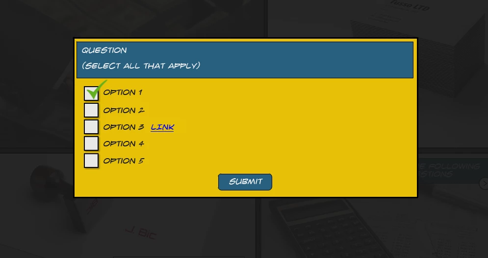

    On a more practical level, your suggestion absolutely makes sense, but as I mentioned already, I cannot format the tick-boxes the way I want + cannot include a link as part of an answer. Also I am not even going to dig into the limitations of the stacking of objects on a quiz slide.
    If you could propose a way to do this (see image) with the out of the box KC slide, I will totally agree with you that the tool should not be "reinvented".
    Thanks again
    B

    Also, in terms of formatting, lets get a practical example.
    The one on the left is out of the box list of answers, the one on the right is a custom list of answers.
    Is it possible to get to what I have on the right with the out of the box solution? Would be good to learn if possible.
    Thanks
